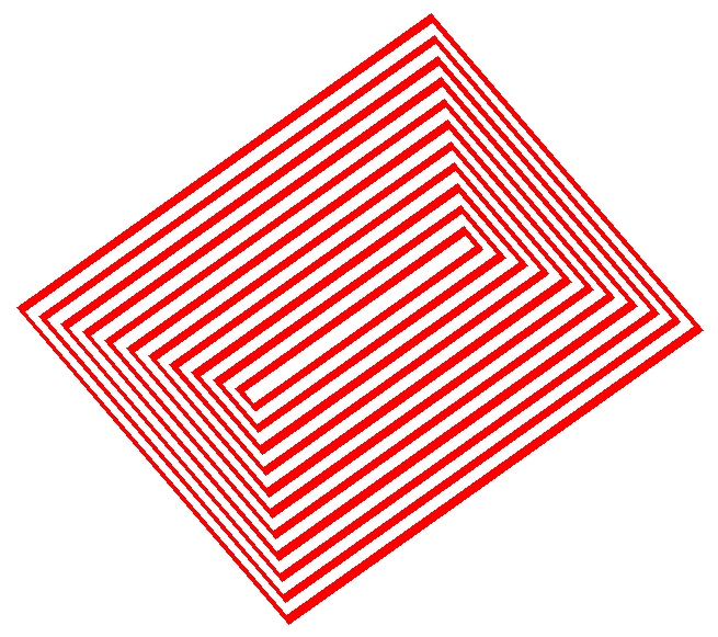

John L
I wonder what software they are using and how to make Flexi do the Fill In as opposed to just the cut lines.
In Flexi... Click the Advanced Tab in the Cut/Plot window. All the way at the bottom - Fill Plot. You can set your pen nib width and the angle that it draws the fill lines too.
