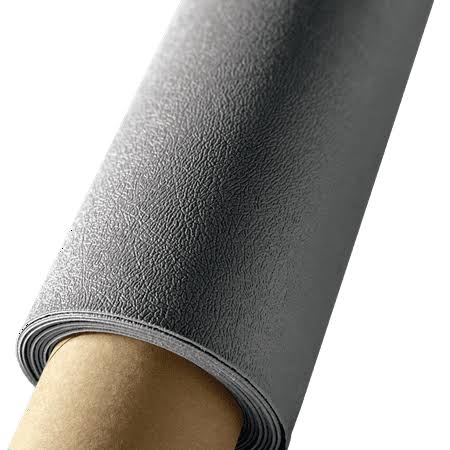

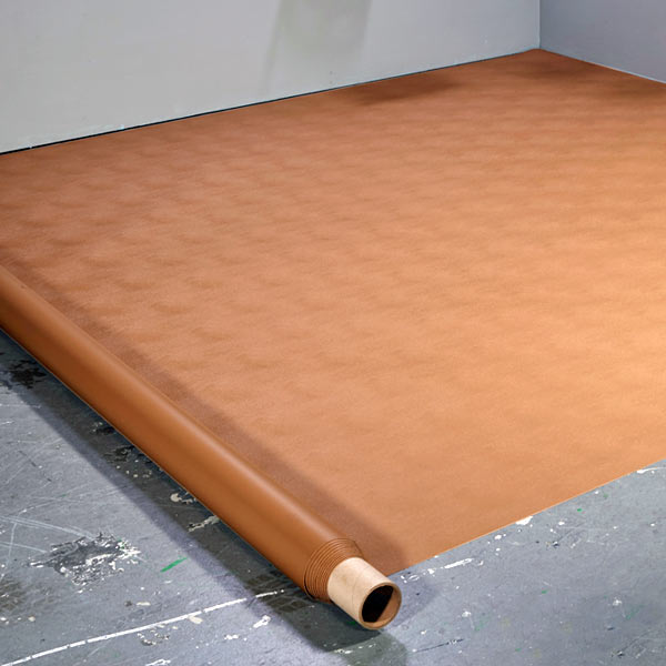

The material that you're looking at is G-floor. I know around here, Midwest Sign and Screen carries it, so check with your suppliers. We have rolls of 4 different finishes here, and the one recommendation I'd make is that you go with the levant finish-it's got a slight "woodgrain" pattern. When we talked to the manufacturer at SGIA last year, he mentioned that the one problem they've had from customers was that if you use the flooring in an area where you're going to be kneeling a lot, the raised patterns can be really hard on the hands and knees.

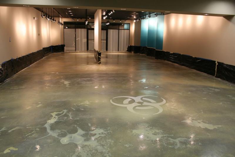

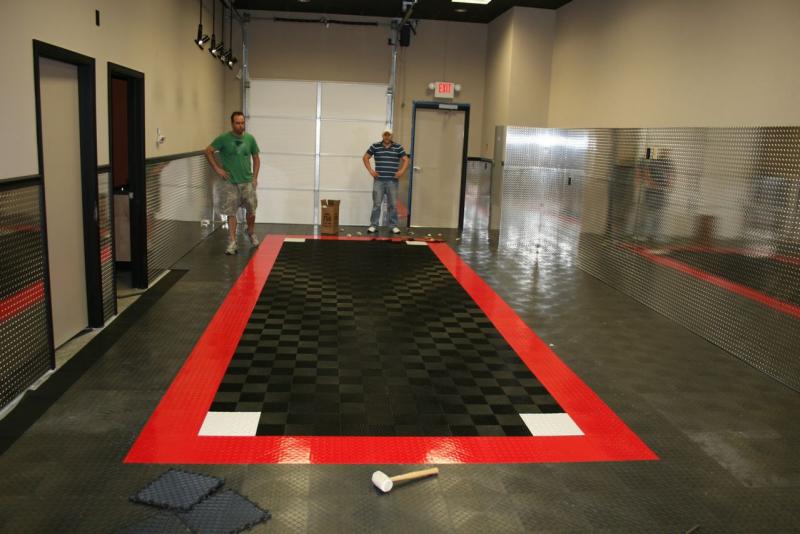

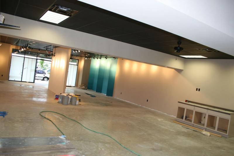

For our sales/display area and part of our production area we have stained concrete. For the back area of the shop we have RaceDeck flooring. Both are great with heavy foot traffic. Here are a couple of pics during the build out.

Under our printers we use G-Floor Levant as a floor covering. It's super flat with a slight texture. The printers and other things can roll over them. Works great if you have an ink spill or something. Real durable and waterproof. Comes on a roll.
