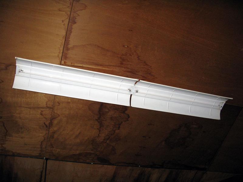

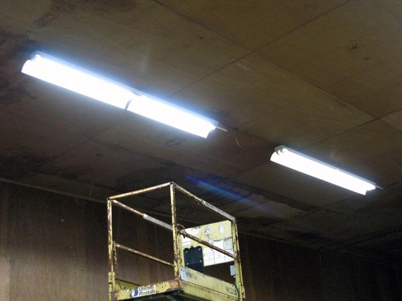

Now - when divided out the per fixture cost is just a hair over $36 each to convert. That being said - my existing fixtures had huge reflectors on them which I just re-used. At a minimum you would at least need the existing strip light can and either reflectors or basic covers. On mine the reflectors are the covers. The reflectors were pretty dirty but they cleaned up beautifully. Ultimately for me this was a lot more cost effective than any sort of LED conversion which would have been a LOT more expensive with a much longer payback. The ballasts mounted in the existing fixture cans right where the original mounted and for the most part I was able to clip off and reuse the existing wire in the can to connect the new tombstones and ballast up. The conversion is surprisingly easy - cleaning the original reflectors takes nearly as long. You simply remove the existing bulbs, covers (or reflectors), then remove the existing ballast, the center cover support, and the 2 end brackets that hold the original tombstones. The new center and end brackets are "bend to fit" and have grooves to make it simple. They come with self drilling screws, you just bend them into a U shape of the right width, insert the new T5 tombstones in the holes in them, then mount the new ballast and connect the wires up to the ballanst and new tombstones, then screw the new brackets to the existing can. Then you just put the covers or reflectors back on and put bulbs in. Hard to photograph them on and show the difference. The one on the left is converted, the one on the right is not converted. In person the difference is downright dramatic. The second shot shows a converted fixture with the tiny new bulbs in.
