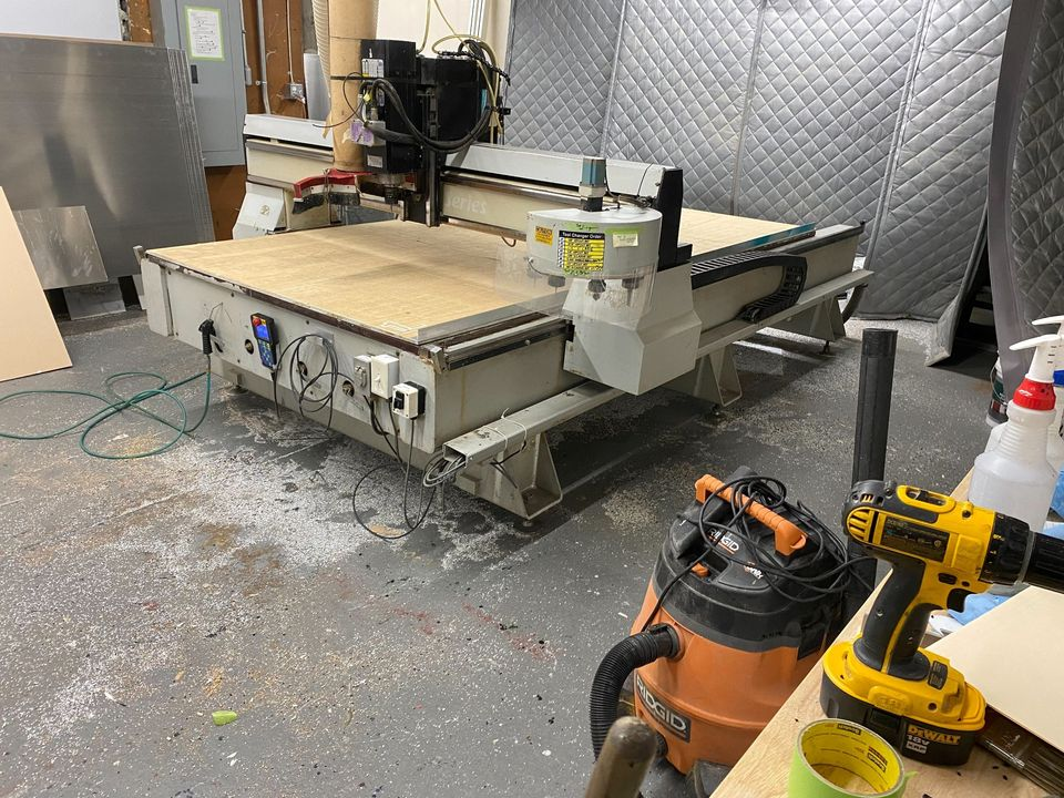

REDUCED - $13,000 OBO!! MUST SELL!! MultiCam MG-204 CNC Router 5' x 10'. Has Vacuum Table, 8 Tool Automatic Tool Changer and Hand Held Control Pad. Currently used for signage - reason for sale is we purchased new router. - Handheld Control Pad replaced and upgraded within the past year - Spindle was rebuilt within the past 5 years - Stepper Cards (X axis) replaced within the past 2 years - Stepper Cards (Y axis) replaced within the past 5 years Router is about 15 to 20 years old, but it is a workhorse! Has a few issues that we have worked around - the Automatic Tool Surfacer doesn't work, but the tools (bits) can easily be calibrated and surfaced manually and the brushed dust catcher must be closed and secured manually. We use EnRoute software (not included). Serious Inquiries Only!! We have more photos and videos - just ask! Buyer is responsible for local pick up in Glendora, NJ or arranging shipping. Items shipping dimensions are 144" x 88" x 57" high and weighs 4,000 lbs. **Please do not ask me for advice on shipping item.**

The only issue I ever had was in a situation where the router was so old (something like 27 years, if I recall) , it couldn't be upgraded when the original electronics failed, so the only drawback I could see on this machine is that it's "15-20 years old." That means that many of the parts may be obsolete or difficult to find, should they need replacing. I mention that because the Multicam 3000 I currently use is eight years old, and some of it's parts aren't available (found this out six months ago when a power supply needed to be replaced). It's good that you feel confident you can make repairs, just make sure your "Google-Fu" is top notch to search for those parts. That "problem" aside, Multicam is (in most cases) an extremely well-built piece of equipment. I've run four different iterations of their machines and they were all outstanding. And that's a good price.
Their listing says it has a vacuum table, but makes no mention of whether they're including the vacuum pump with the table. That's kind of important to know, because having a vacuum table with no vacuum pump is pointless. If you have to buy a pump yourself, I strongly suggest you contact MultiCam to get the proper specs for a table that size. You'll also want to ask if they're including the debris vacuum, as that's another added expense if not). It's size isn't as important as the hold-down pump is, you just want it to clear plastic chips/dust and sawdust. Don't use the debris vacuum when cutting aluminum or metal- the coolant you use with end up allowing the dust to build up in places that will reduce the effectiveness.
I second the ideas of having them cut 1" squares and circles to assure the machine operates without "jitters" (you'll know them when you see them) and cuts true, and of taking them a simple vector design and having them run it. It would probably be beneficial for you to watch the operator set the files up for cutting, too. And yes, you'll also want to check the condition of the rails to assure there aren't missing teeth, corrosion, or slop (meaning you shouldn't be able to move the gantry- even a little- in any direction when the machine is powered on and the motors are engaged).
I disagree, however, with the take that "upgrading usually means that they are not stupid" (implying that there's a flaw with the machine). If the machine is 15-20 years old, as the ad says, and they're the original owner, it's just as likely that they're upgrading because they find that a 5'x10' is no longer adequate for their production needs. It's quite possible that they've decided they need a much bigger table.
You'll definitely need software to run the machine. The EnRoute they mentioned is a top-notch CAM software that will create G-Code for you. Simpler, less expensive CAM programs exist, but they tend to require a familiarity with G-Code language to perform some functions, so base that choice on what you're most comfortable with. In any of the CAM software, you'll import your design (though EnRoute does perform the most basic of design, it is not intended to replace programs like Illustrator, CorelDraw, FlexiSign, SignLab, or any other vector design programs), nest it to the material, assign the tooling, and output for cutting. If you (or your operator) doesn't already have some degree of knowledge in operating a CNC router, there will be a learning curve.
I see no mention of tool holders, collets, collet nuts, or wrenches (to change tools). Ask if they're included. Depending on the spindle's requirements, the tool holders can be expensive, so it's a huge bonus if they're included. If not, count on spending another $200 (each) on them for the holders, plus $30 and up each for the collets and collet nuts- all of which will need to be replaced periodically (so make sure you keep them clean and it good repair).
Having run tables with and without ATCs, it's a definite plus, and you're definitely going to want to get a new calibration pad (the surfacer) to make things easier. Most machines with ATCs will have certain minimum air requirements- and don't forget to factor in the rest of the shop using the compressor at the same time- so you'll need to figure out if your current compressor is up to the task. One additional not here is that you will want add a dryer to your air. You do not want to risk moisture in the air line that feeds this machine, because that will cause spindle failure, and spindles (depending on size and horsepower) start in the $15k area and go up. Rebuilding them because of water damage- count on that starting around $5k. (I know this because I once worked for someone who insisted on running the brand-new CNC they'd bought without a dryer, and ruined the spindle within the first six months).
You will also need to make sure your shop has enough electrical capacity to run the table, the vacuum pump, the debris vacuum, any compressor upgrades (whether it's a more powerful model, or an additional model) and its dryer.

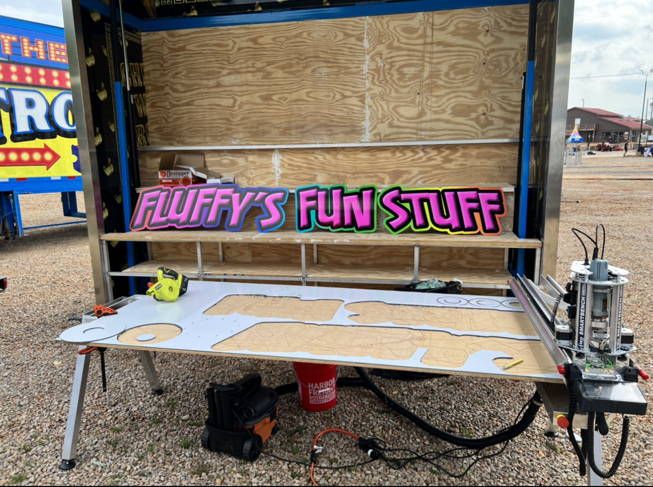

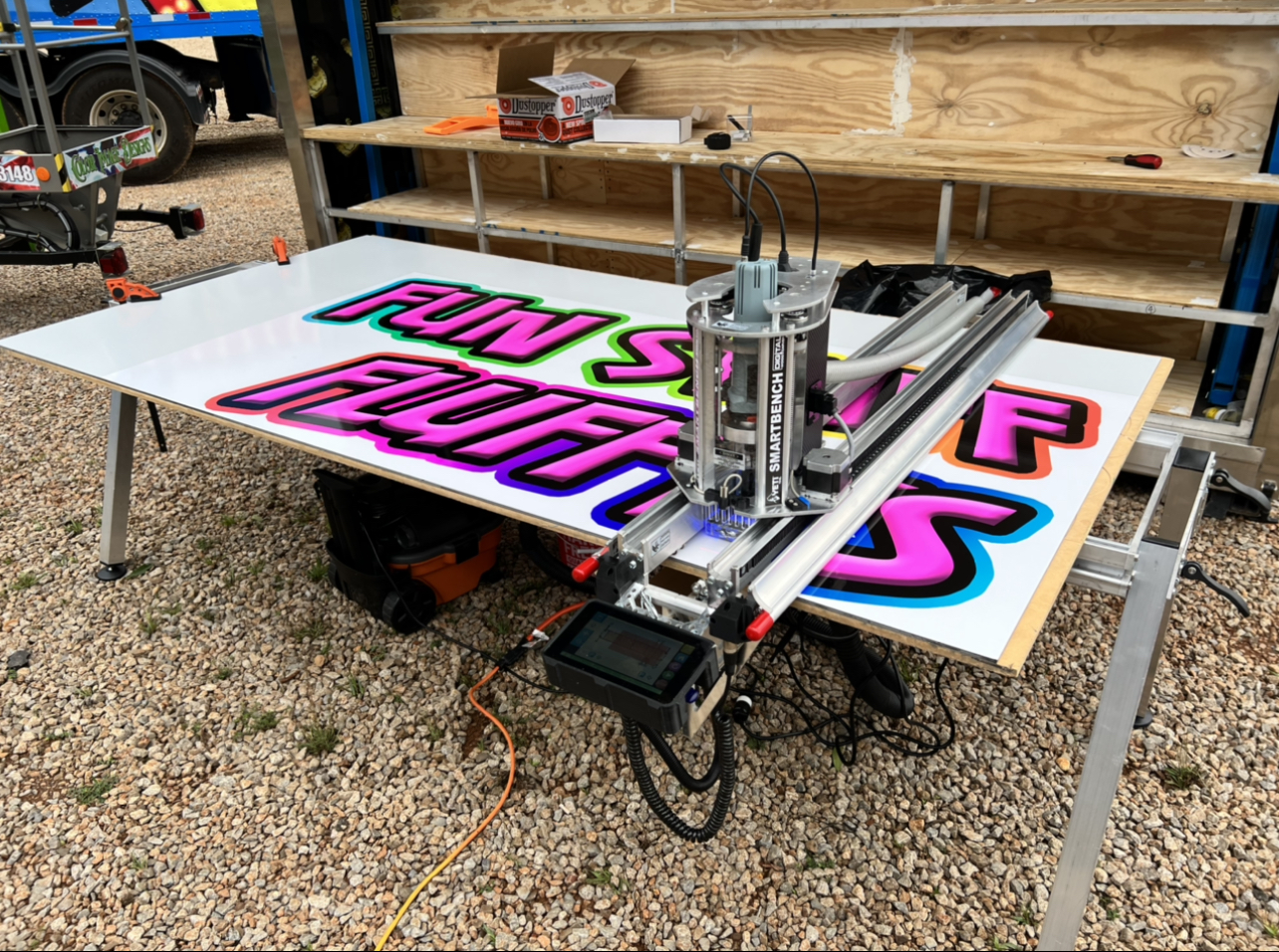

We picked up a yeti Smartbench precision pro for under $10k and it does everything we need. It can be assembled and disassembled fairly quickly. It’ll cut full 4x8 sheets. We’ve used it for cutting 6mm ACM without any problem. It all depends on your needs. This has worked very well for us being a mobile shop and space is limited.
It's not even remotely in the same class. I can see the appeal of portability but the OP is asking about an old production-class machine. Smartbench isn't a production machine, It won't ever be expected to run 24 x 7 or handle 8 hour shifts 5 days a week for years on end.
