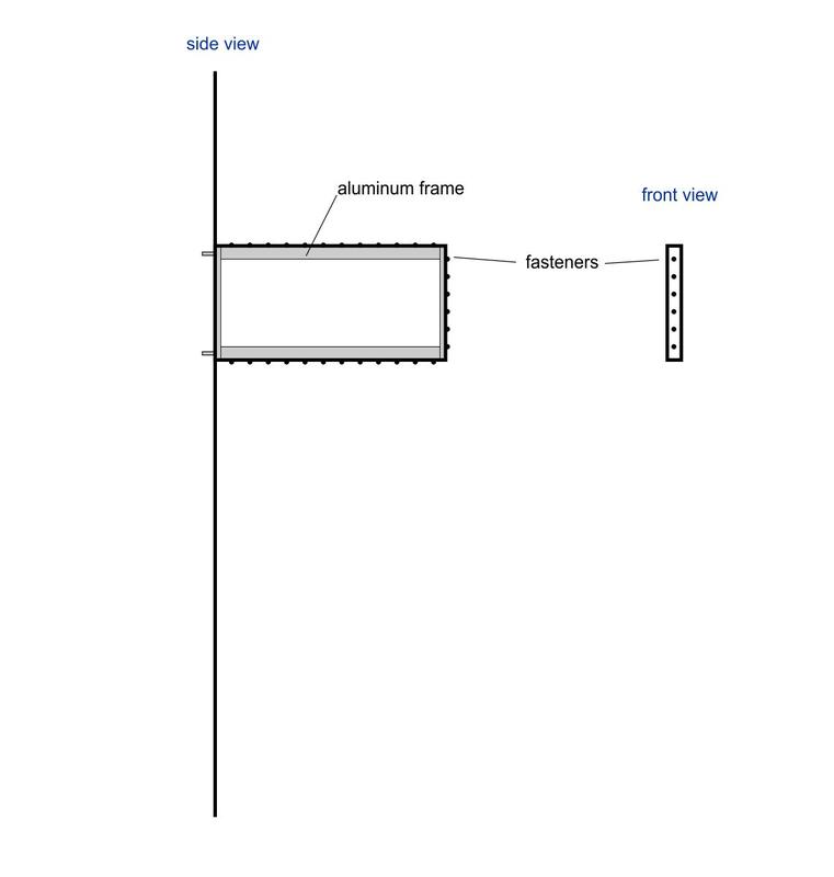

I think there should be a frame and the aluminum panels should be bent on the edges, so the fasteners go from the sides.
Is it the right way of doing it?

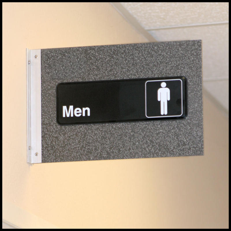

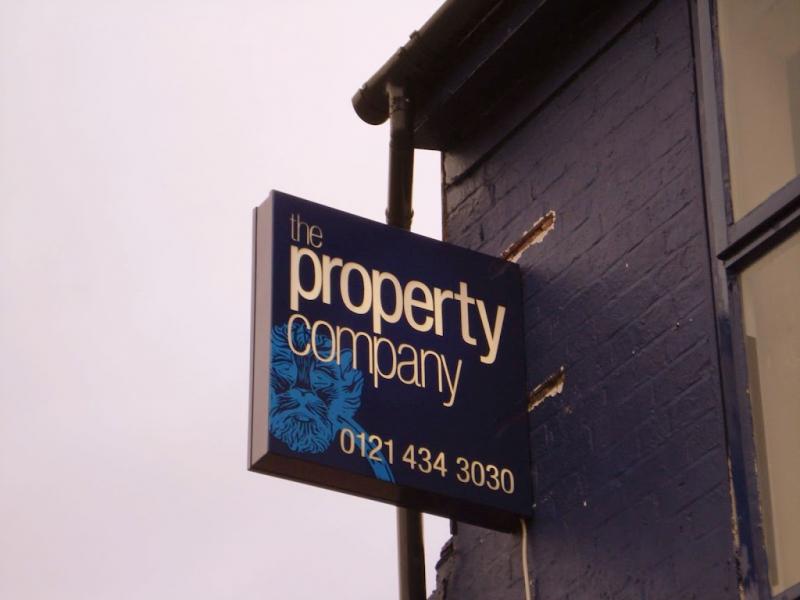

to make it look like this, only with no illumination

2 pieces of 1x1 aluminum angle "sandwiching" the sign is an option. You can shine/clean the angle with a scotchbrite pad.

For a little interior sign sure, for anything large outside, no.
One way, have a frame with the fastening plates welded as one unit.
Attached to wall and then skin it
