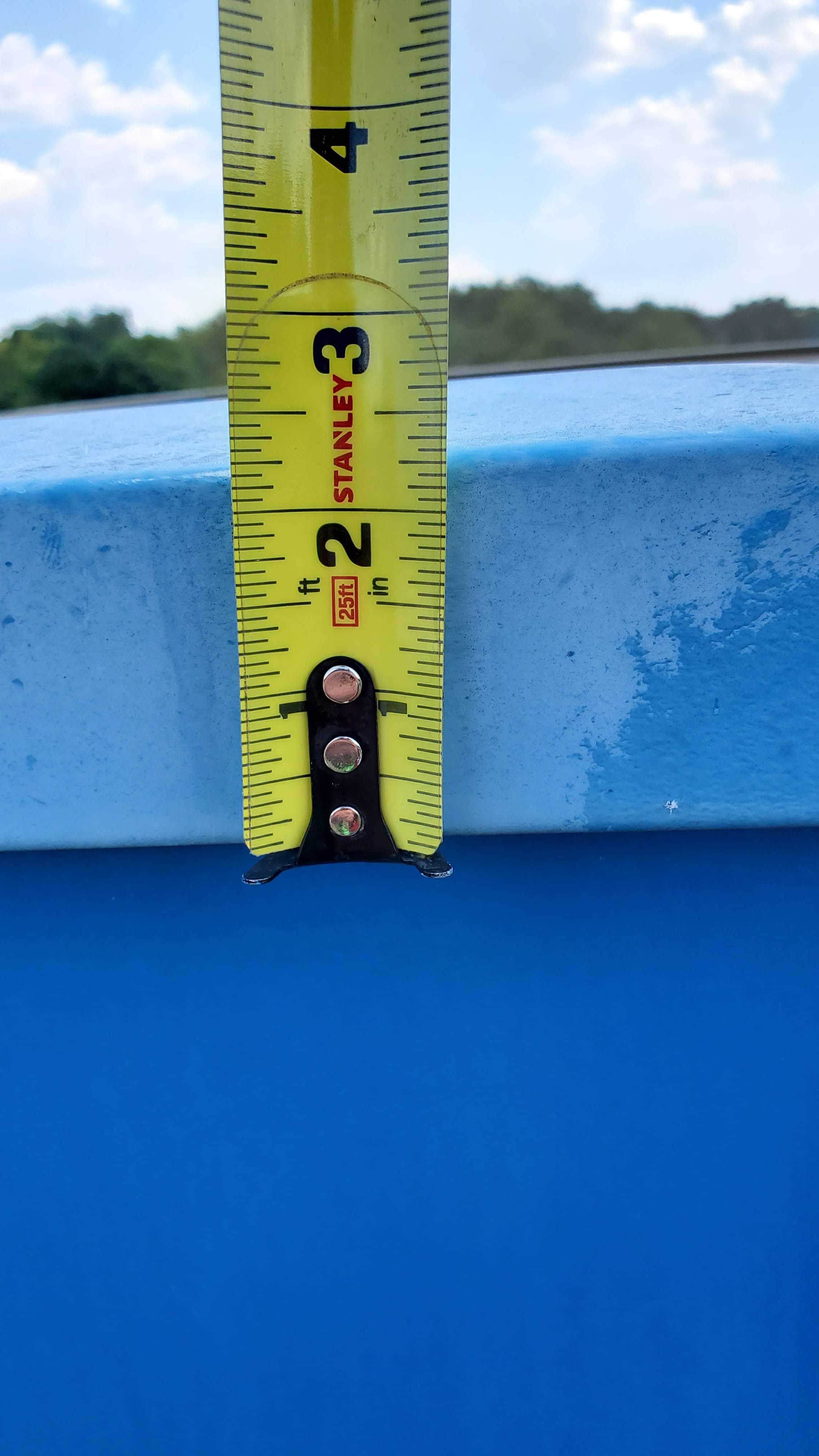

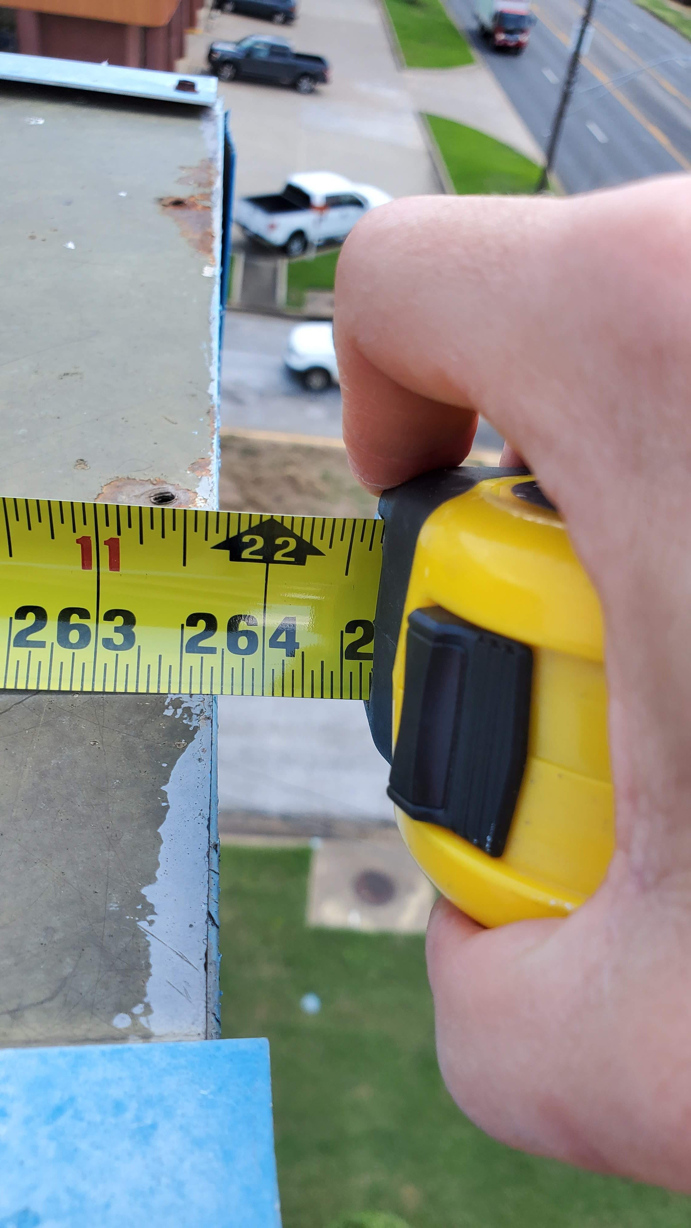

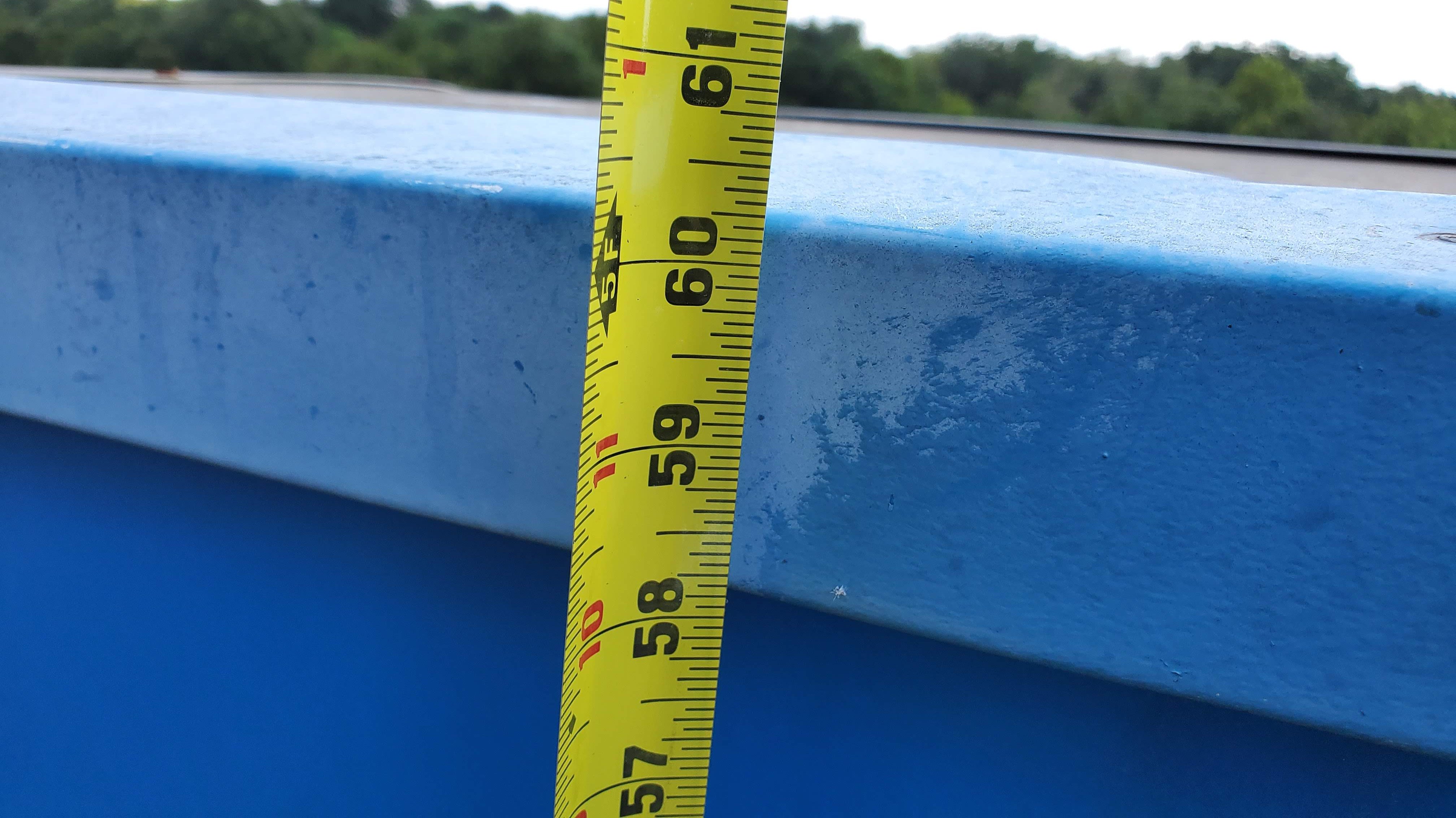

An easy way to check that is to ask for photos of the measuring tape on the cabinet.
I always take pictures of it when doing a survey and that way there is no question how big it is.

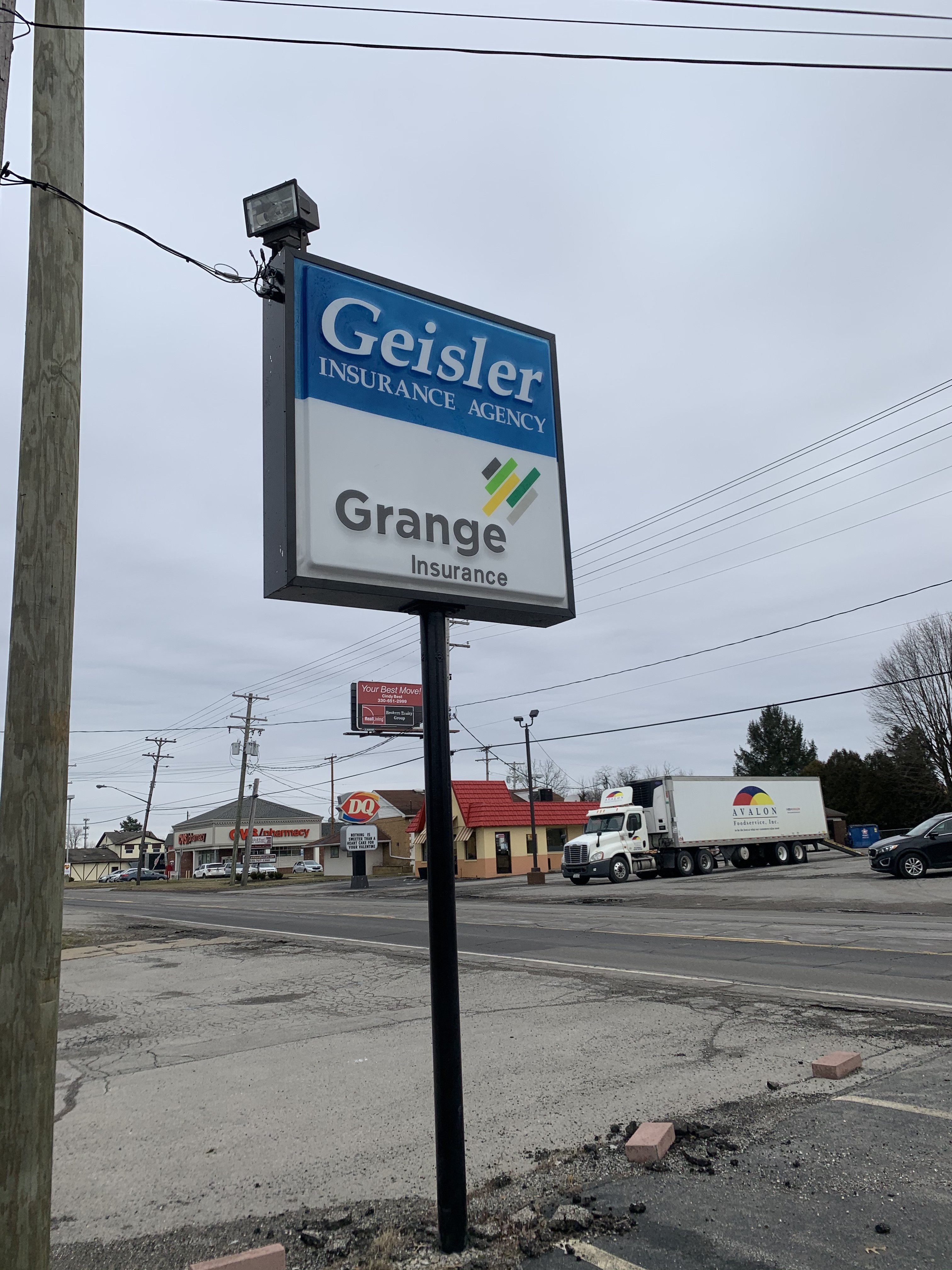

Here is a pic of the actual box I need to make the sign fit into
So, what was the picture in your OP about ?? This one is a pan face. You can't save that if it's the wrong size, plus you'll have hot spots all over it. You need exact measurements and pan faces created. Ya can't guess with those things, or you're out a whole lotta money.
You shouldn't replace a pan face with a flat acrylic face. The lights will be too close to the sign face. The pan makes the face more stable so it won't bend or blowout.
So you don't know how to get an accurate survey, you're not using the correct materials, you need to rethink this entire project, you seem out of your league on this one for sure.
yeah. this is a custom made pan-face. You need to know the outside dimension of the panel, the depth of the pan, and the flange width.
if you quoted someone for a flat panel, you need to go back and admit to your mistake. The pan face will cost at least 3x as much as a flat panel.

Sorry I wasn’t really clear guys. I’m not a commercial sign shop I do embroidery, screen printing, and small format digital printing. A “friend” sold me both of the signs for this box at $350 a piece. Not being familiar with large outdoor signage I trusted that he would give me the correct product I needed for that box. I wasn’t trying to cheap out, he even told me that they don’t produce “blow out” signs anymore and the acrylite sheet was the way to go. I didn’t have a picture of the actual box when I posted this but the second photo I uploaded is the actual sign.
Marshallmax
By the way guys, I also should add that the lights in that box do not work. And I don’t plan on being at my current location past this year so I am okay with the lights not working. So hotspots would not be of concern to me.
