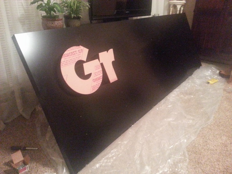

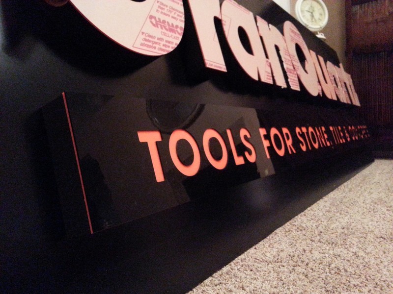

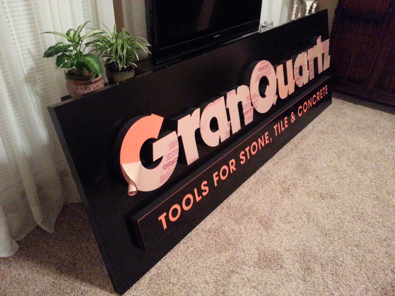

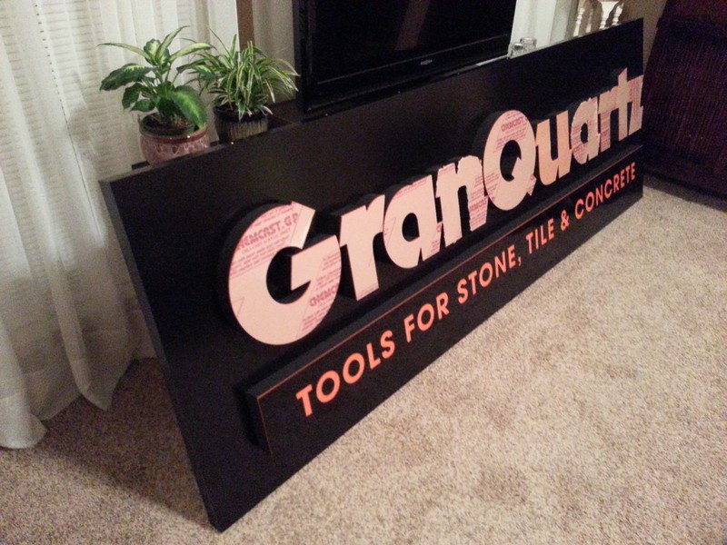

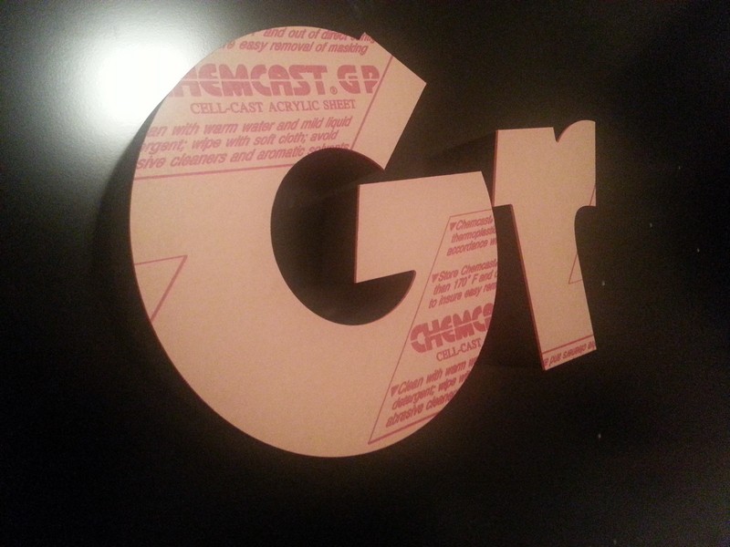

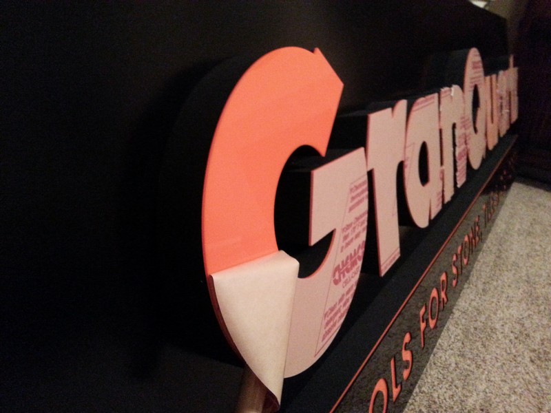

Home sick, so took advantage of the time to get this assembled. Pretty simple, nothing mind-blowing...
2" Signfoam laminated with .125" orange acrylic. Tagline has an additional layer of .125" black acrylic overlay with cut-out letters. Letters and tagline are mounted to a 3'-0" x 9'-0" x 2" aluminum pan panel.

NICE work, did you cut the letters with your CNC router?
:thumb:
Thanks...I sub out the materials and just handle the assembly and installation.

That's a nice-looking sign. Also curious whether you cut everything yourself or had them done somewhere, can't say I've worked with foam+acrylic combos before although I've seen samples. I guess it allows you to get the thickness without spending tons on thick acrylic?
Either way, nice work :thumb:
lol...the benefits of home office. Comfy work environment, free drinks and food, good music.
Yeah, the foam and acrylic just give it a different look....gives it some dimension and color at a pretty decent price.
Moze
I had the vendor adhere the acrylic, but they use silicone for outdoor signs and epoxy for indoor.
