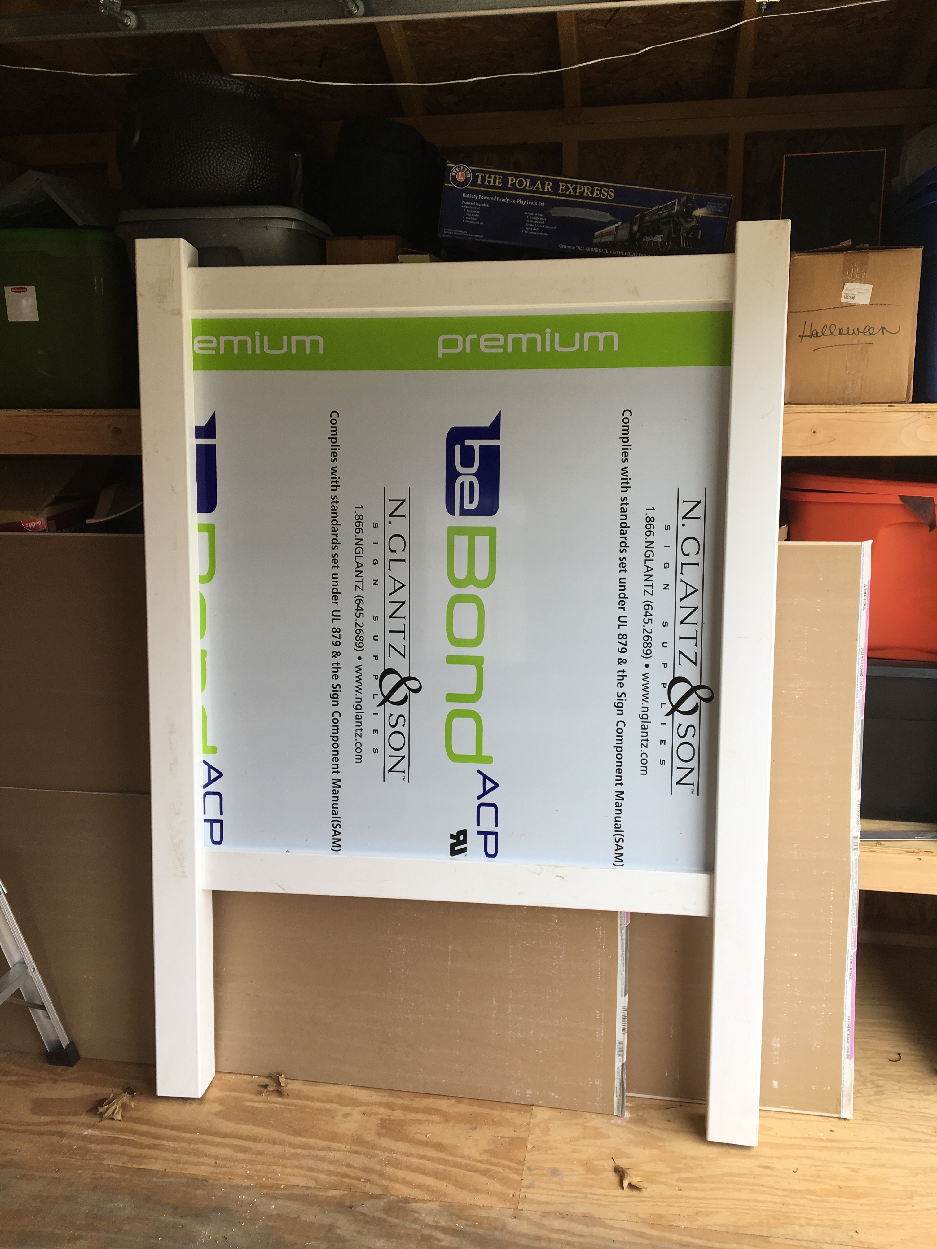

I use metal "L" brackets for top and bottom stringers.. this may be overkill how I built it but I wanted it to last a while....and it was double sided

Is that double sided BeBond or is there a reason you put the masked face to the inside of the sign? Maybe I've been using it wrong the whole time, but I always peel the BeBond graphic off the face I want to use, at least for single sided BeBond.

Now I'm confused. It was a double sided sign that I used two double-sided bebond panels for. I left the backing on it because the backs were going to be concealed. If it was a single side sign I would have pealed it off. I only stock the double-sided bebond boards even if I'm only using one side.

Really? REALLY? Very unprofessional to leave the backer on the substrate. Looks horrible. I've seen quite a few signs with the backer on them and it peels off and looks terrible. Please remove your backers.

He clearly stated in an above post that it was a double sided sign in which he used two double sided panels.....

Not a real price difference between single and double sided...easy just to stock one type. That and I think the double side is thicker or stronger..but that could be all in my head.
