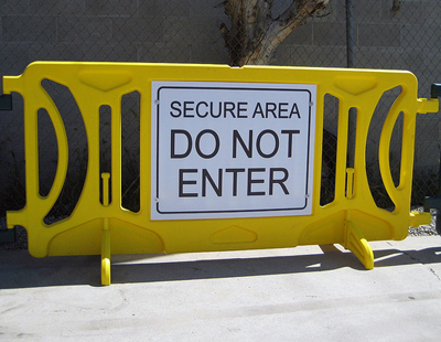

I have a customer who is ordering a lot of the billboard style barricades, similar to the attached photo. They will be used ta different events, and each event will need a different sign with the event's logo. The barricades aren't in yet so I haven't actually seen one, but the specs from the manufacturer indicate that they hold a 28.5" x 36" sign. What is the best material to use for the signs that attach to the barricade - coroplast? THANKS!

If your doing Crowd/ Traffic Control situations. I would go with aluminum with radius corners. Probably reflective viny also would be better.

Another option would be to print fabric/banner covers for the barricades. One large banner that folds over the top of the barricade, with velcro down the sides. That would allow for much larger advertising.

Here is the product page for this item. I would call them and simply ask what material is used or spec'd for this application.
