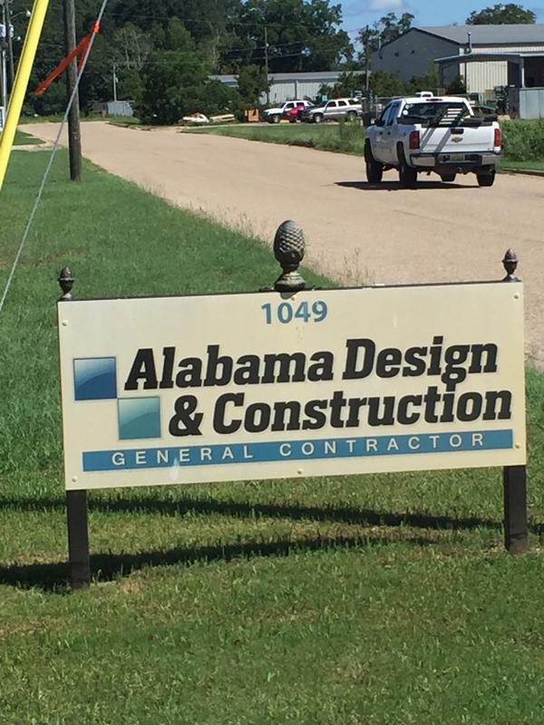

Went to a client I did some signs for back last year, he called said his signs were fading out, actually they were "browning"

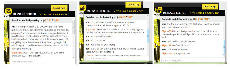

Got back to shop and looked up the date of the ordered prints and immediately contacted signs365, emailed them the pic at 11am per their request on chat, I have yet to hear back as if they will reprint. There was one part of the convo I did not appreciate. Right off the bat telling me the material chosen is considered "Temp"
I dont know how this will end up and Im going to be patient one more day and await a response. Im hoping to God this was not a widespread issue and was only isolated. Im not making this post to "bash" them. I appreciate what they have done for my biz over the years. I hope they step up to the plate
I have attached the chat and pic of sign, the background of the sign was white

I've never gotten 5 years out of Oracal calendared laminate. I'm lucky to get 2-3 years. Anything going outside which needs to be laminated gets 3M cast.
jman
Anytime I have a issue with anything from them which is rare but it does happen, I call and ask for Ernie. Ernie always gets things taken care of for me and doesn't give me a run around. I have also talked to Mike I believe and he's done just as good job.
oksigns
I've said it before and I'll say it again, per the material spec sheet, it is rated for 5 years under ideal conditions UNPRINTED.
Throw solvent ink on it, unseasonable weather AND laminated, then subtract a year or more from that.
T_K
I've used tons of Oracal 3640 vinyl with 210 laminate in the past. I wouldn't expect more than 2 years max outdoors on this product. Between the sun and heat in Texas, signs here take a beating.
From the picture, it looks like these are in full sun most of the day. So the product will age a lot faster than something in partial shade.
I'm not suggesting you shouldn't pursue this with your printer, but it'll probably be a tough sell to get them to reprint.

Wow... I've been seeing a LOT of posts lately on this problem, all seem to be calendared lams getting hit by the sun. The sales people here don't like dealing with me much on this, because anything that's going outdoor for longer than a weekend long event, or short term store promos I always push to do cast over cast, and they have to try to sell it to the customer. I win most of the time and our customers usually agree to the extra cost for a better product and outdoor lifespan... I'm going to show our sales manager some of these posts, and tell her THIS is why I push so hard to use premium materials if they're going out in the elements.

Yes, in the southern US we get hammered by the sun. Much more so that northern US or Canada. Plus we get over 100*F / 39*C air temperature for extended periods of time. So the prints & substrate in the sun get MUCH hotter than in other regions.
Have you ever cooked eggs on the sidewalk? Baked cookies in your car while you're at work? That's the kind of sun and heat we get down here.
