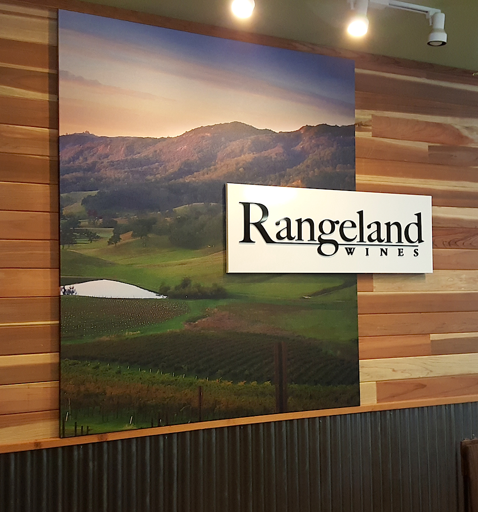

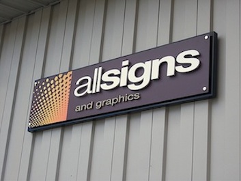

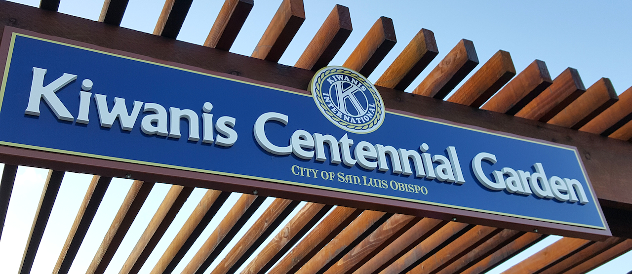

These are very common sign types for us and we have been using a combination of LEXEL and VHB on the raised letters for years and years and have never to my knowledge had a failure that I am aware of.
To be totally clear, we use mechanical fasteners WHENEVER possible to be 100% certain of our process.
As MikePRO and several others have affirmed, the trick is to not press the letter into the surface so hard that your adhesive film thickness narrows to nearly nothing.
