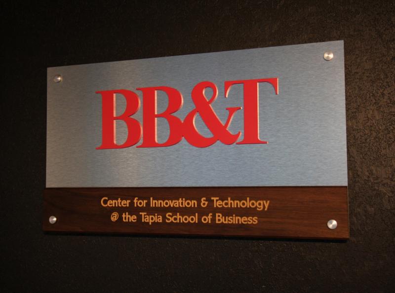

Such an easy sign to design and create. 16"h. x 28"w. Some scrap brushed aluminum polymetal. A small piece of walnut wood for the carved lettering. And 3/18" acrylic for the BB&T logo. And the aluminum stand offs. This is to recognize BB&T for a $1.4 million donation to the universities school of business. I wish they were all this simple.

Very clean looking.
Pass off with some more info.
Where the walnut come from ?
3/8 red plexi or clear that you painted ?
What kind of bit for the small letters ?
SignManiac
Very clean looking.
local cabinet shop
3/16" red acrylic laser cut, painted with Matthews PMS corp color red
110 degree v bit
