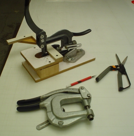

Anyone have a good way of making slotted holes in .040 blanks?
We use a hand punch all the time to make regular holes. My welder has a slotted punch on his iron worker, just wondering if anyone has a hand punch that does slotted holes?

Doug & Mosh- you really need both of the Roper-Whitney punches on this page-
they are quality tools- I have 2 of the jr's and one of the XXs with the
holddown brackets. Also have a couple cheap (Harbor Freight) punches for
light duty use. It is handy to be able to leave the good ones set for the
most common sizes. Here is one of the jigs I use... this one can be configured
to punch the short side of 12x18 blanks and corners of any blank.
PS- farther down on the web page there are slot punches and dies for both
units.

We have a unit like the blue handled one in Gene's picture. Works pretty good when we need it.
