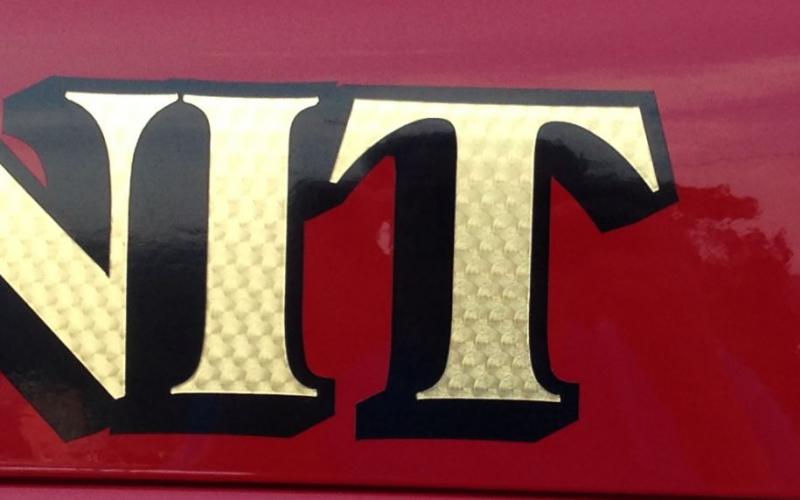

attached

Unfortuately not all small engine turn is created the same, and if you are matching existing you need to know what it is. I have gotten burned making that mistake.

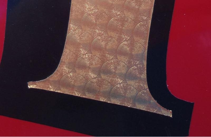

This is about the best picture i have of the gold. I never ordered the engine turn gold before. So not sure what to buy.

Looks like Signgold...but can't really tell from a photo. Like I said I've been fooled. Now I either use a sample to match or order the roll & don't do anything till I hold it up nect to the old one to match.

Not too bad of an idea. I will keep this in mind, I found a sample of avery small engine turn gold and i think this is pretty close.

I would explain to the customer the advantage that you are offering by laminating and encapsulating the gold vinyl to extend its lifetime.
If you have the diameter of the turn, that would be helpful to us here, as we have no sense of perspective like you do.
We use a lot of Leo's gold products, but I think this is something different (possibly signgold as stated above) but it looks like Small engine turn (SET).

Its the 1/4 small engine turn.
