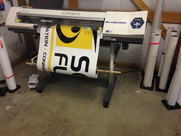

player
Printer comes with deluxe custom media take-up...

Fred Weiss
Merchant Member
You might be falling into the trap of thinking that your supplier's only costs are the supplies expended in producing work for you. There are significant other costs including labor, equipment, overhead and earning a living providing it.
What it comes down to is you either have enough business to cover the legitimate cost of producing in house or you don't. Many of the printers, cutters and laminators you will find on the used market are the result of someone else falling into the trap of thinking they were overpaying for someone else to produce a product for them. You might want to shop around for another supplier before you jump into a comparatively heavy investment to bring production under your roof. But don't expect that there are solutions out there to produce professional products cheaply.
