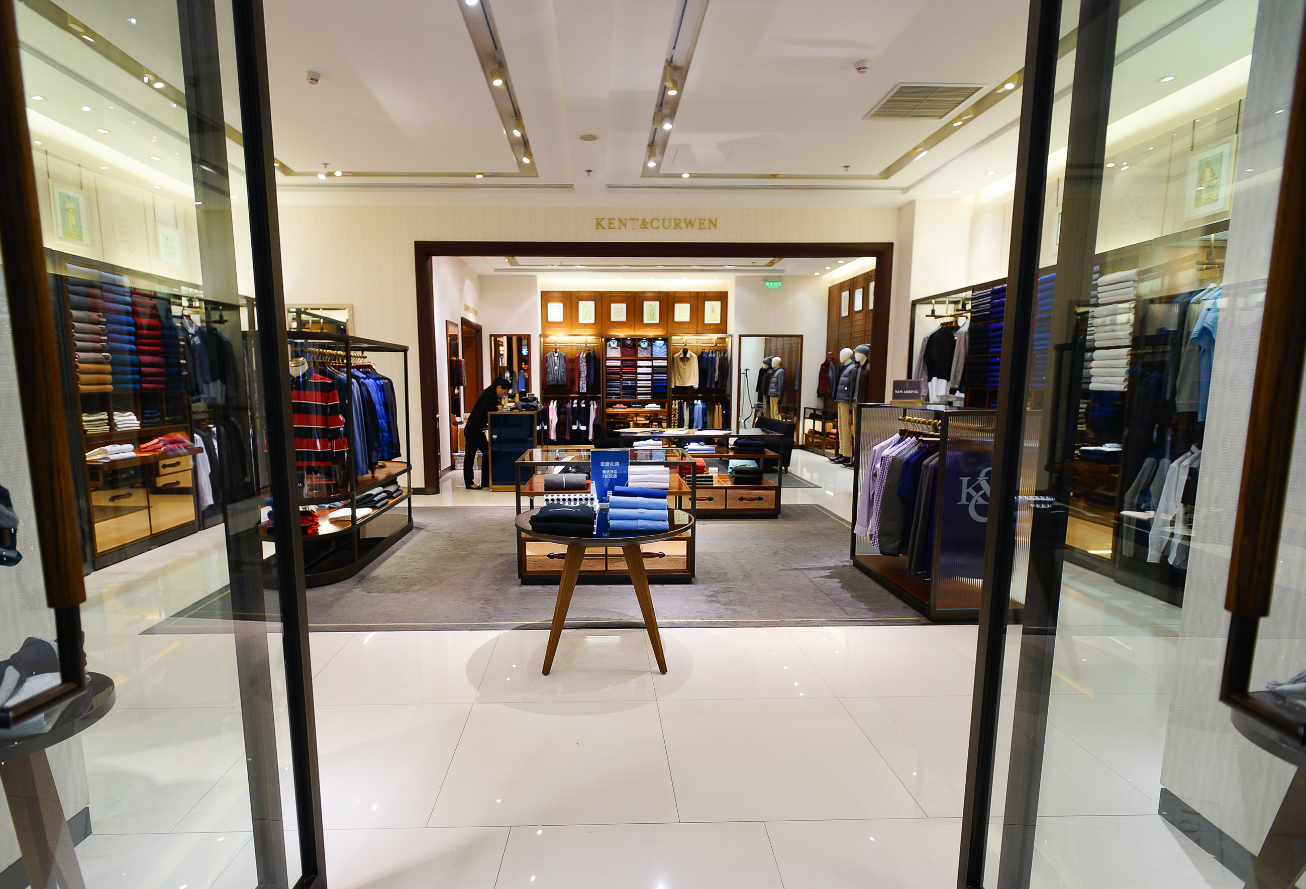

Hi all.. I bought this image 220mm x 150mm 300DPi .. I want to make it approx 6 meters by approx 4 meters for a shop front.. we all no were this is going lol :)
Best ideas, suggestions etc to stop it pixelating really badly.. I have imported it and worked it all out at 25% scale as normal to try and help but its still pritty bad.
Publishing from CorelDraw X8 to PDF then into VersaWorks rip to Roland RF640.. I also have Adobe CC illustrator and Photoshop if that would be a better road to go down?
any suggestions / help would be splended :)

Bring it into photoshop and enlarge the image to whatever size you need but make sure to select the option, "re-sample" and then set the setting to, "Bicubic Smoother" This is the proper way to enlarge a file. There is software out there that uses different algorithms etc. enlarge files but I haven't seen any better than what I describe above.

Sounds like you might have some issues, even at 300 dpi (dots per INCH). How many dots per centimeter is that ;)
If it was me, I'd get the DSLR outta hock and go get a RAW image of the nearest Kent & Curwen store, touch it up, and work from that. Can't beat good source material.

Thanks Vander :) .. JT I tried asking for the NEF raw file but shutterstock are not having any of it lol.. simple.. I bought it as 300 Dpi so tuff :)

Correct me if I'm wrong, but you are going from 5.5" x 8.5" to almost 20' wide and over 12' high ?? That sounds almost impossible, if those numbers are anywhere near right. Not only do the good pixels get blown way up and outta proportion, but so do the bad ones........ and they'll be a lotta bad ones.
How close/far will the on-lookers be ??

Your image is 2598 x 1772 pixels and you're printing it 6m x 4m (236"x157"). That means if you print the image as-is, you're printing at 11 pixels per inch (ppi).
Here are the standard viewing distance formulas we use:
  • resolution (ppi) = 180 / viewing distance (metres)
  • resolution (ppi) = 600 / viewing distance (feet)
  • viewing distance (metres) = 180 / resolution (ppi)
  • viewing distance (feet) = 600 / resolution (ppi)
So using the italicized formula above, your image will look fine if you're viewing it from at least 16 metres away. If you scale it up 300% in Photoshop before printing, it'll look OK from 16/3=5 metres. You won't get any more detail by scaling it up, but it'll prevent visible pixels in the print from that viewing distance.
