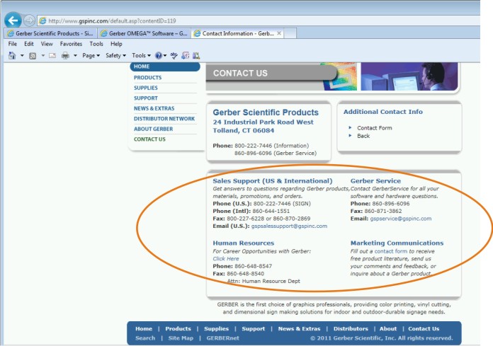

I have been having tons of issues with 5.0 and when I went to the Gerber site to find support, I don't see any way to contact Gerber tech support. is there a number? e-mail address? there is so many things going wrong in Omega, I need to find out what is going on.
signage
Here right off their site
software and hardware questions.
Phone: 860-896-6096
Fax: 860-871-3862
Email: gspservice@gspinc.com
