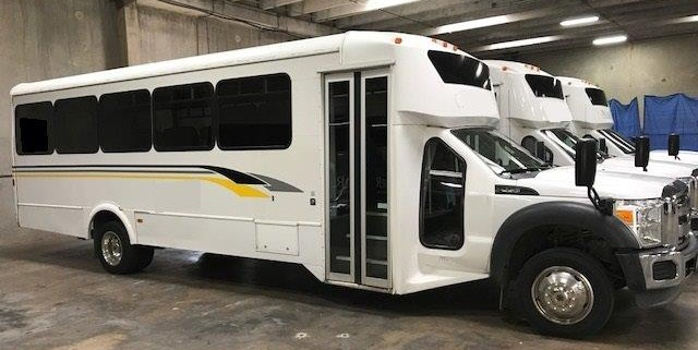

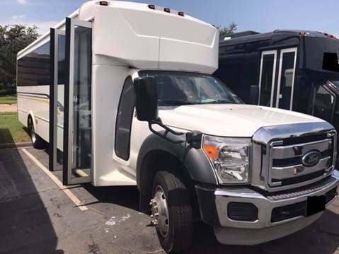

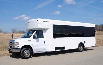

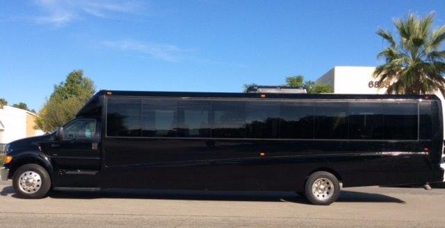

I have a customer with a bus company. I need to come up with a solution for them and I don’t know if there is a product out there that would work. We usually letter their buses with "cut vinyl lettering". But they have a few buses now that they use on the weekend for private parties and when they do that - they can’t have
the bus lettering showing on there. So they need to somehow on the weekend cover up the weekday lettering. Magnets wont work here because the buses are fiberglass. I have photos of the buses. Do you know of a solution ?

Billct2
I think the customer should put a little more thought into their identity. Is the issue that they have large commercial graphics which wouldn't be appropriate for high end private charters?
Is it just a few of the vehicles that are used for the private charters? Around here some of these companies have a more discreet corporate identity graphic for these types of vehicles.
After all, they do have to have identification of some sort, just create a more sophisticated design for them.
