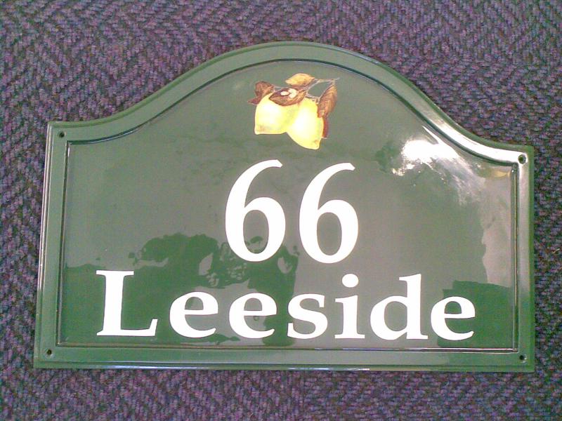

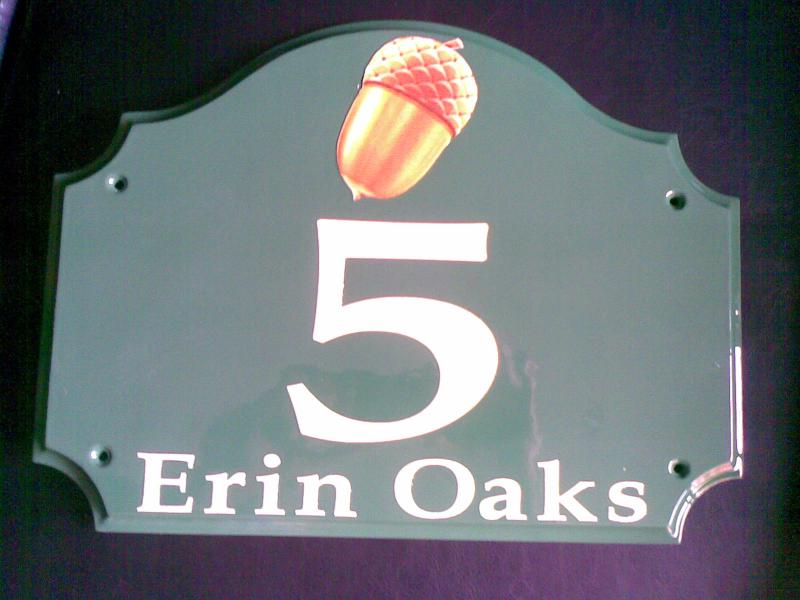

Some more handmade signs by Fatboy.Please give crit.
Fatboy
Hi there guys. I love this site.Learning so much already.Some more pics.

Are these painted? Is that why you call them handmade?
I like the shapes, and the contrast is very good. I think your eye for good layout needs a little tuning.
Not sure if this was mentioned, but a good book is 'Mastering Layout' by Mike Stevens. I think you would gain a lot by reading that book.
Jillbeans
While I do like your sign blanks, I have been taught to make the shape of the sign fit the layout, not the other way around.
I would seriously consider losing the decoupage elements and trying to find suitable clipart to cut.
I would also recommend not running all the lettering to the edges of the signs.
Choose what you want to stand out (probably the street number) and highlight it in some way.

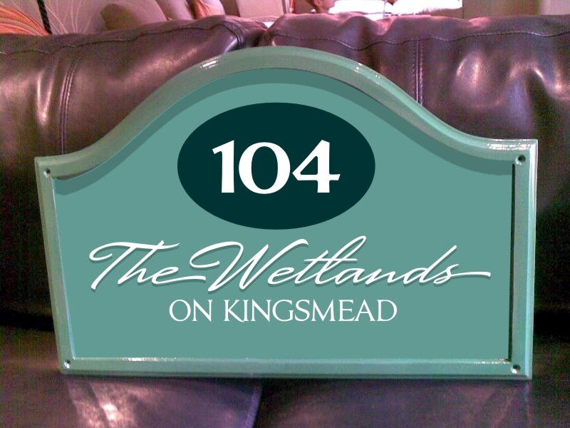

Here I used a panel.
I chose the most confusing of your examples to redraw.
Hopefully I have it in the right order. My fonts are all a bit thin.
You might also want to consider the use of smalts (tiny glass beads) or learning to apply gold leaf. That could really increase the selling price of your signs after you learn to do simple effective layouts.
The second pic is one using an HDU sign blank purchased from a member here.
I used both matte and gloss paints, gilded gorilla glue, and smalts.
Love....Jill
Love....Jill

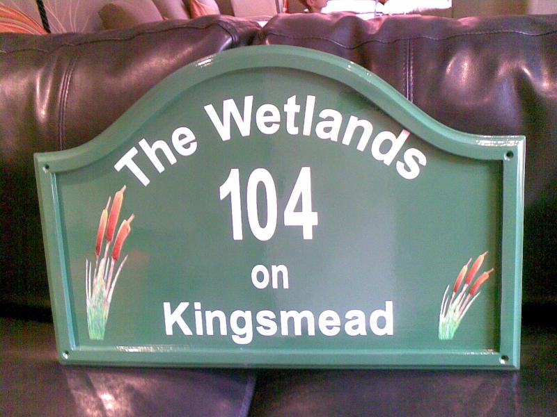

Try to place the number where the blank arches up. Look at the shape of the blank and design to that. You also need to consider what is important when people look at the signs. The chances are there are already on the correct street. So thats not the main priority, But the Number is, so make that nice and visible. It may be worth considering the number and surname. If I was looking for 123 any-street to go and visit Mr Anyone. I would find the street fairly easy but once i'm there i'm looking for clues to the narrow it down even further. I have a number and a name. So I am looking for 123 and Anyone.
So consider:
123
Anyone
Just my 2c
Ian

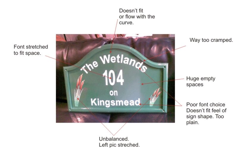

Ok, here's some specifics. Again, I'm not trying to bash you at all. You're well on your way and the fact that you're asking for advice and taking it says alot about your determination.
And I really like the looks of the blanks. I think there could be a market for those. :)
