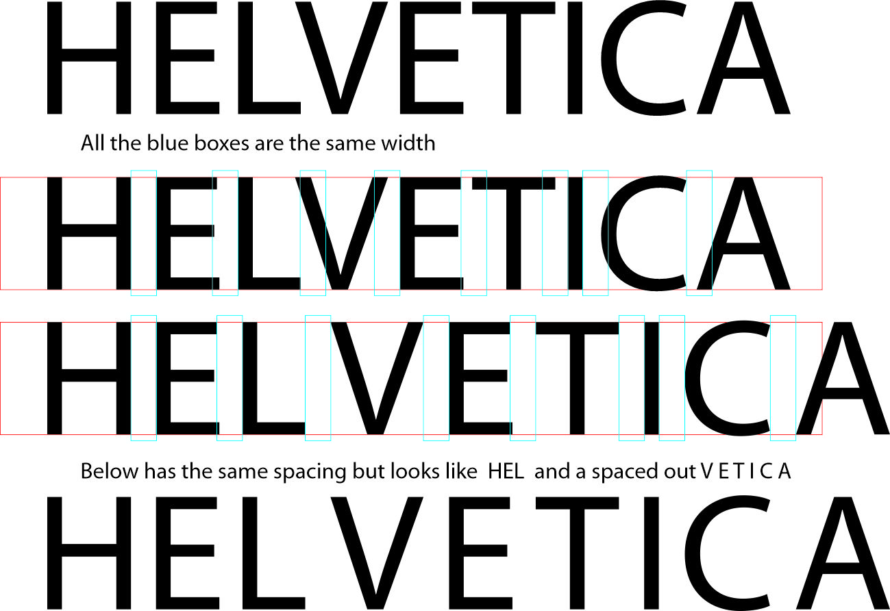

Jester1167
Yes, visually they need to extend to appear the same size. A flat character has a lot of weight at the top and bottom, if the round character doesn't go above and or below, it will appear smaller. Same thing with kerning pairs. T's A's and round characters are spaced closer together for the same reason. All these factors make the spacing and height look the same.
This is one of the reasons you measure to flat characters during an install, or the same character when using script fonts, otherwise, you end up installing them crooked.

What he said. Round letters appear smaller if they're the same height as the flat letters.
