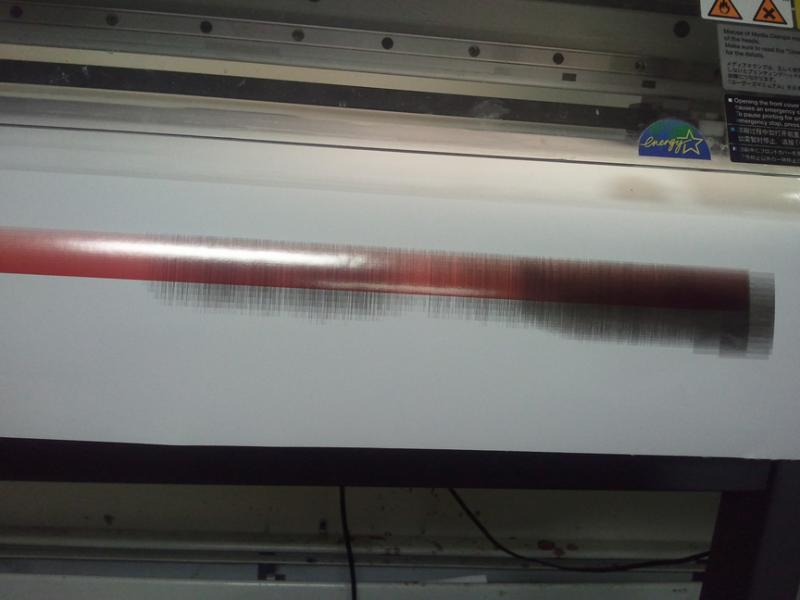

SP300 and started having a problem printing black. Called a local tech and after 3 visits and 3 weeks of screwing around with it he determined it was the fuses on the main board that were blown. Ok fine, he ordered and got new fuses and installed them, then after all that he said it was the main board and we needed a new one for $1500. We did some searching on the web and found a guy in NY that fixes the boards, we brought it to him and he tested it and so no, its not the board its the print head without a doubt. SO we buy one, I am pretty savvy so I decided to install the new pint head myself. I went through all the steps meticulously. Now its in and I have 2 issues. 1.) I cannot get into service mode, I did the whole R/D/L/R/U and so on thing but cannot get into that sucker, keeps saying service mode protected, so I have no yet calibrated this thing correctly. 2.) I did do a quick test print just to see whats up and I am getting what looks like a rubbing on the vinyl from the black, which is the head I just replaced. I dont know if its because of the calibration not being done yet or something else. Please we are already 3 weeks without printing, I know its getting late but if anyone can shed some light on this and help us out we would greatly appreciate it. Pic of black rubbing attached.

artbot
that's bad data. can be caused by a bad cable, loose cable, bad carriage board, or bad head. most often it's a data cable that isn't properly seated.

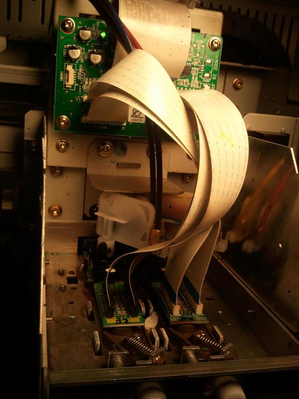

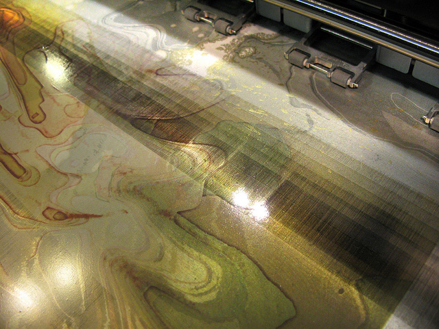

this is my printer doing almost the same with a loose black data cable. you can do a data swap on your printer to see what is going on (head vs/ boards). but confirm with an 300 owner that your cables are routed to the carriage board properly.
it sounds like your "tech" didn't know anything about diagnosing. sorry you are dealing with so much printer drama. i've been down for three weeks buying bad heads etc. grrr....

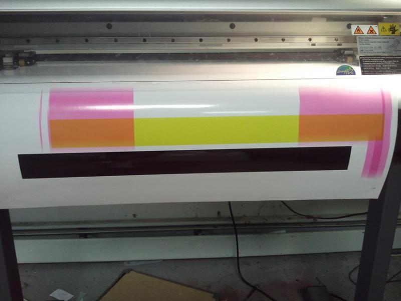

Ok all, I am getting somewhere but nothing is resolved. Here is the latest and I think I am getting closer to finding what the issue is. I am including 3 images, one of both data cables being swapped, another of what I printed through Versa Works and finally the end result of what came out. Keep in mind that the data cables and now swapped as you guys recommended. If you look at the image of what should have printed via VW and then what actually came out, its INSANE! Forget the colors being correct, again because the data cables are swapped, but magenta squares are printing when they shouldn't be, the second color which should be blue (but is now yellow because the data cable swap) is no where in line with the black on the print as indicated in the VW screen shot. So YES, it is definitely a DATA issue for sure, but now I am really stumped, I got a new print head, a verified good mother board and these are the results. I am eagerly waiting a reply from someone here! I keep getting d****d around by local non knowledgeable tech guys and I am going on a month with backed up work. Any attention to the matter is greatly appreciated.

artbot
sorry. i read the paragraph. maybe i stayed up too late working. the colors will print in the wrong positions because the printer believes the heads are in their original positions. the colors are inverted as well. that's supposed to happen. the reason for the data swap is to see if the issue migrates to the new head (data problem) or stays at the head (head problem). sorry if this was redundant.

I know they will print the wrong colors because the data cables are swapped, that exactly what I explained. And yes, the screwed up printing issue did migrate the the yellow - red- print head when I swapped the cables. So again, yes I know its a data issue, with all the information you guys have posted and the testing I did, its looking like its either the data board, data cables or both. Before I go spend another penny on parts that wont resolve this issue, I am hoping that someone here will tell me that I am right in my thoughts on this and to go buy a data board and a set of 4 cables.

as far as the cables being bad. you can do a cable swap too. completely take out both pairs of cables and reseat them in the other ports (laber them 1234. they can get mixed up if you lay them on a table). because during a data swap, the data and the cable are one in the same. as far as buying a new board. take it out and ship it off to macmedia. they will put in on the bench and see if it's good or bad. only $200 to rebuild. otherwise you could be throwing money at the printer. they work fast too. over night it and they get back with a result quick. very honest company.

I think it is similar to the issue I was having. Its not the print head or the print head cables because you switched them at the carriage board. The issue on my printer was actually the cables from the main board to the carriage board. My printer has 3. It looks like you printer has 2. If they are the same, try swaping them(MAKE SURE YOU SWAP ON BOTH ENDS NOT JUST ONE END LIKE THE HEADS). Just a warning, It is a pain on the VP540 because you have to take some of the top of the machine apart and they are a pain to handle. That being said, it is a free solution that you can try before replacing parts. In my case, that turned out to be the issue. Switch the ribbon cables from the head back now that you know they are fine. Good Luck.
njteaser
That was it! One of the 2 cables going from the carriage board going to the main board had a bent pin! Holy Shiz! The tech we had here must have mistakenly bent the little metal prongy thing on the end of the ribbon cable, we saw it when we opened up the main board housing and reseated the cables. Its is printing good now but definitely needs to be calibrated correctly. Shall I go as far as someone respond and tell me exactly how to calibrate this sucker, then we are good to go...
