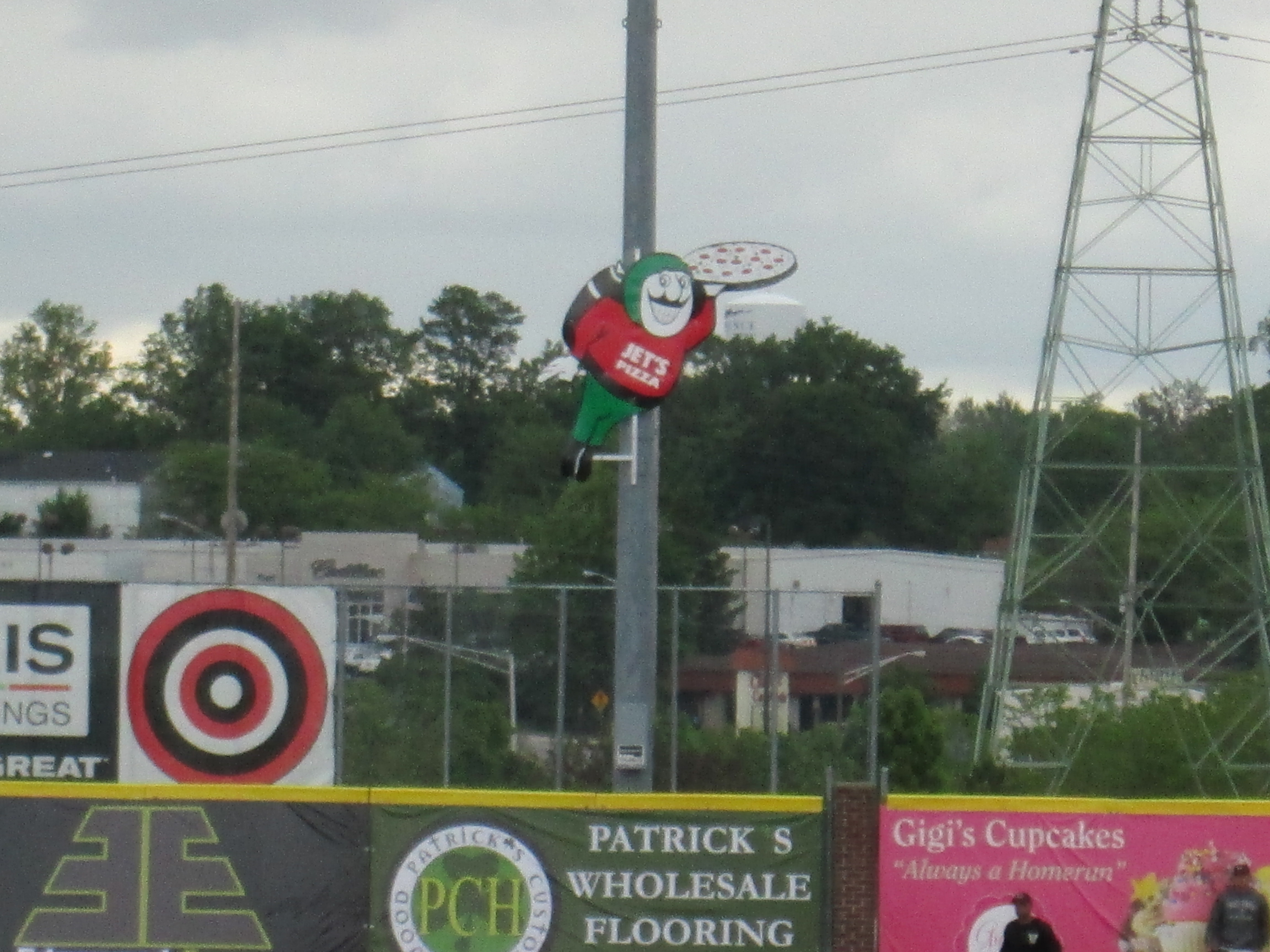

We used a series of Aluminum angle along the back of the sign using carriage bolts for a very similar sign. I think he was around 4'x8'. We clamped the angle to the poles with some very large heavy duty "hose clamps". Worked fine for years even after heavy windstorms damaged almost every other sign there at the stadium.

Nice that looks ideal. Thanks we were already planning on doing angle back there for some structure so this set up is perfect.

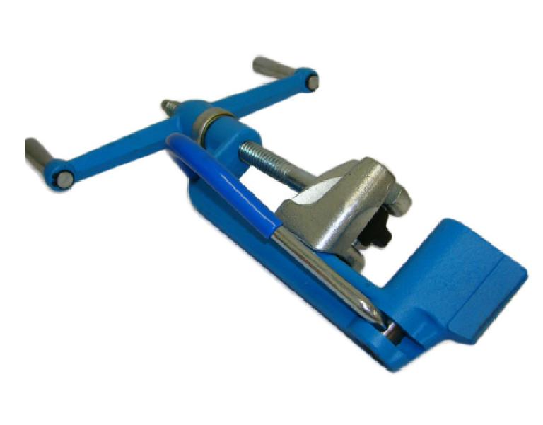

Good timing, I just got asked to install a sign on a pole, similar to this. Will check out the metal strapping and clamps.
