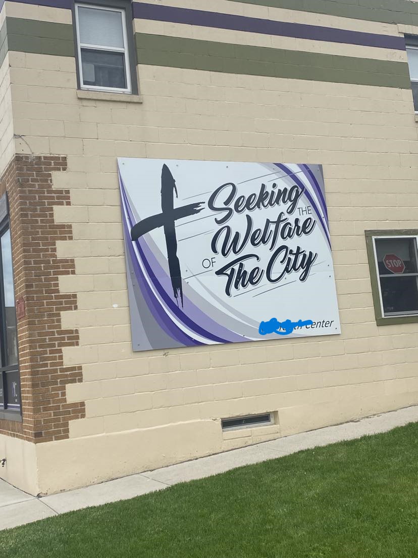

I recently made a sign for a church and they wanted to install it themselves - which was fine. However, they used stand offs and they are stainless steel and right in the middle of black so they stick out like a sore thumb. What can I suggest to fix this? Nail polish? A vinyl wrap over the top? There's gray and purple on the sign but the stand offs blend in where those colors are. It's the black and white spots that look horrible. The stand offs are 1" in diameter and about 1/4" deep - if that makes sense.

Here's the crappy thing. It's a 2 part sign. I just called her and gently suggested they paint the ones on the seam. She said they did discuss that. I said they could use nail polish or enamel paint and a small brush. I've used nail polish here and there and it seems to hold up well.
I didn't know they were using stand offs and the project has been a year in the making. I should have said something when I delivered it!

Ditto ditto. They can spray paint the standoff caps if they want them to blend in more. I did an install once with four different colors of spray painted screw heads, depending on where they fell on the sign.

It looks the same to me as if someone were to do screws!
If you REALLY want it to blend in - I have a customer who makes me print a sqft of each color on certain signs.... Then she goes overtop of the screws with that vinyl. It blends in pretty good... rather than paint, print a few FT of the colors / bring the white, and wrap the standoffs. I personally prefer the standoff look... But printing a couple pieces of vinyl would look a heck of a lot better than them trying to nailpolish them :roflmao:

Looks good from my house.
Is this a real problem, or a 'I made it and they ruined it' kinda problem?

1 Shot paint but most here probably don’t have that. Not sure about nail polish…
I wouldn’t worry about it since you didn’t install it. Photoshop them out and put it in you portfolio…
