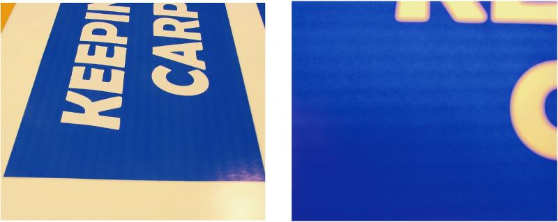

Banding photos 1204
I attached a couple of pics showing the banding problem that has just started with my printer. Again, it seems more prevelant in certain colors.
I hope the pics are visable enough to see the issue, although, the one on the right is a little blurry.

Which direction are the banding lines, in the printhead movement direction (horizontal) or the feed direction (vertical)? I would suggest adjusting the media feed compensation. It's called Distance Adjust in the Mutoh. On most printers using straight line pass printing, you see light or dark lines when the media feed is incorrect. When using one of the wave patterns on the Mutoh, feed compensation not being correct looks like what you are getting.
Pinfinity
Thanx Jim...I believe the bands are from the horizontal printhead direction. As the material feeds out front of the printer the bands are showin across the material horizontally.
Jim Hancock
Old School Technician
Don't remember for sure which way the lines show when the dist adj is off, but give it a shot and let us know... I believe the effect is a harmonic of the wave pattern when the feeding distance isn't correct. Keep in mind that this setting can change the actual length of the file, so once you get it corrected, you may want to run some tests to get a correction percentage on files that are length critical. And never change the media feed or distance adjust in the middle of a tiled job, because they will never line up.
