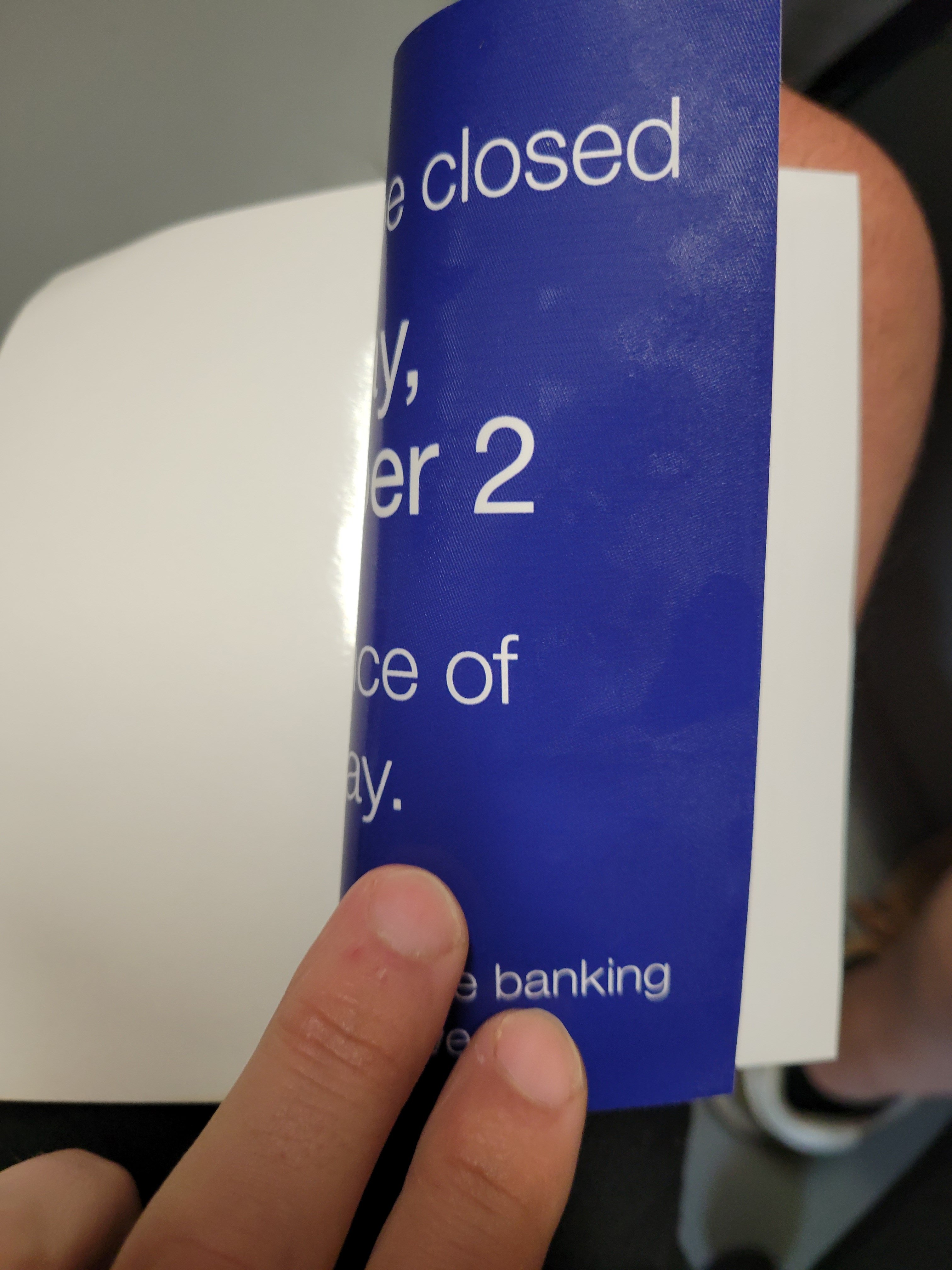

Pardon my lack of experience with some prints here. So I have a sample of what I'll be doing because they wanted a similar material. Material is a 3M controltac not sure what spec, but it's obviously removable adhesive with a white back.
So my question is how was this done? I'm guessing clear 3M with the blue printed and then a white vinyl laminated over the top of it.
I'd rather not have to back it with white and would rather print the white save me time from masking out crop marks and cutting them out so I can cut the final piece on my plotter and just run them straight to the plotter after printing.
Also this feels pretty substantial, like around 6-7mils. Are there any good removable adhesive vinyls that would work well on glass that are that around around 6mils?

If you have white ink capabilities you should go that route. Just guessing... Whoever produced their sample probably didn't have that capability, so they had to use more material to back it.
Yes, I do have white. Only reason I had quoted that job for them so I can put some use to my UCJV330.
Just need to find a material similar to this 3M.
