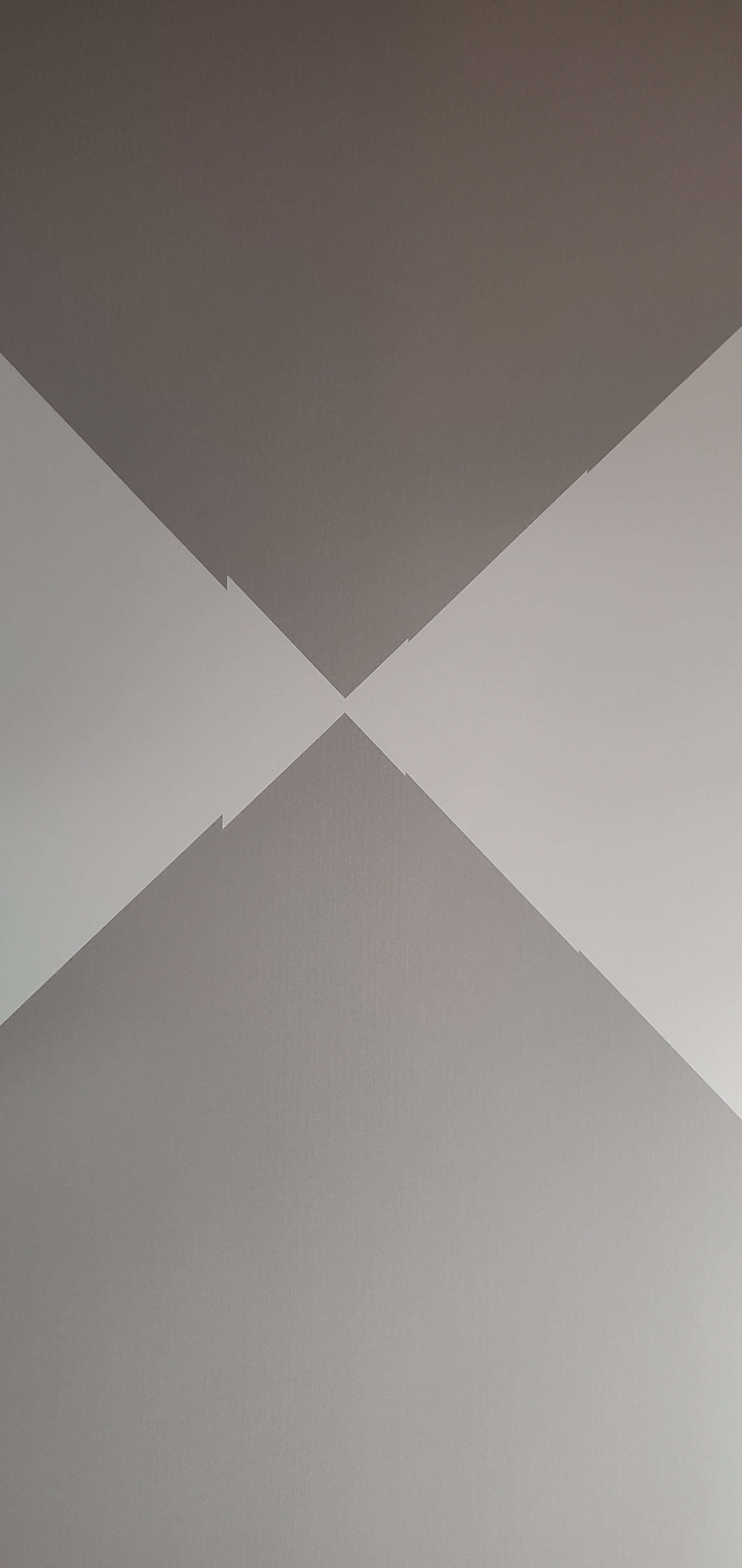

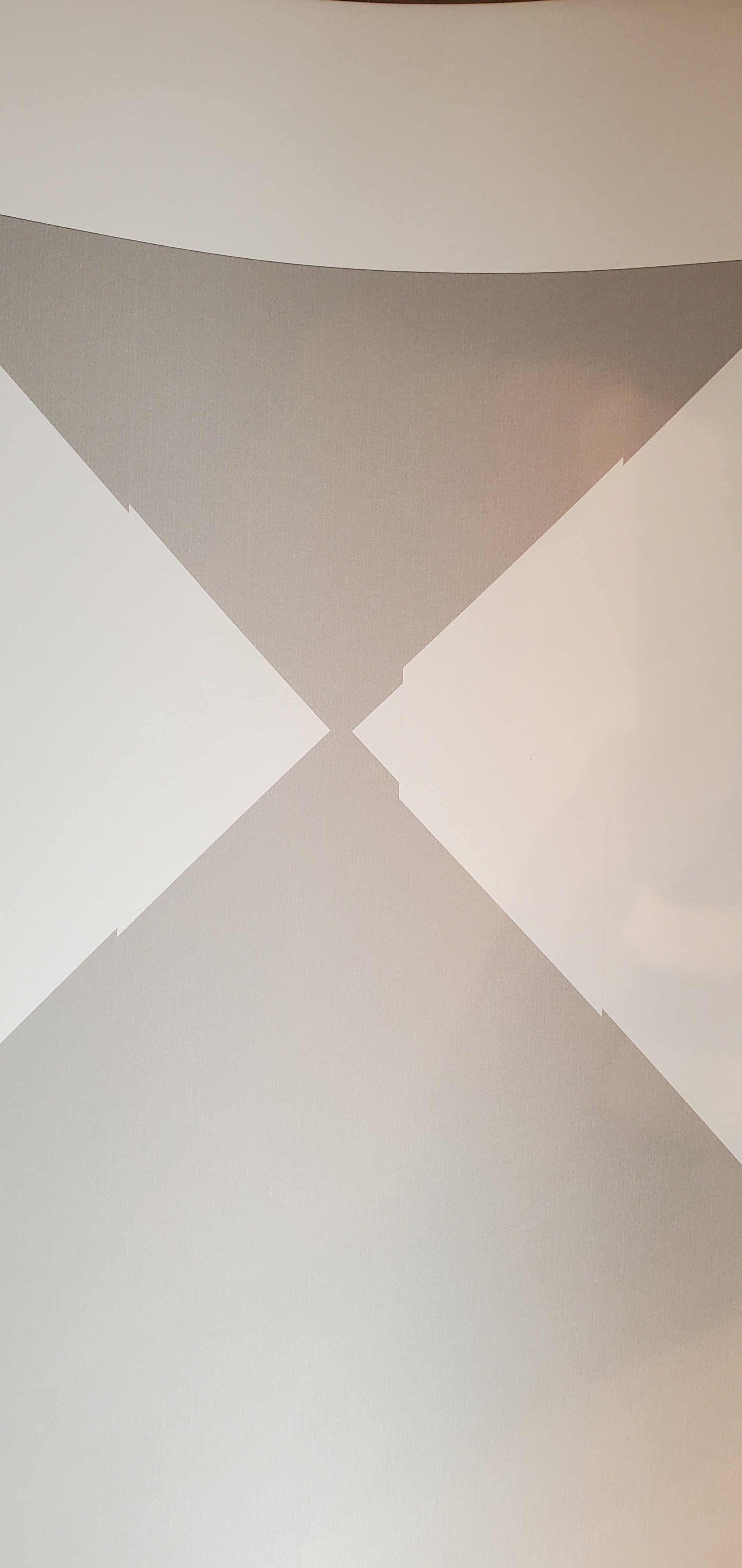

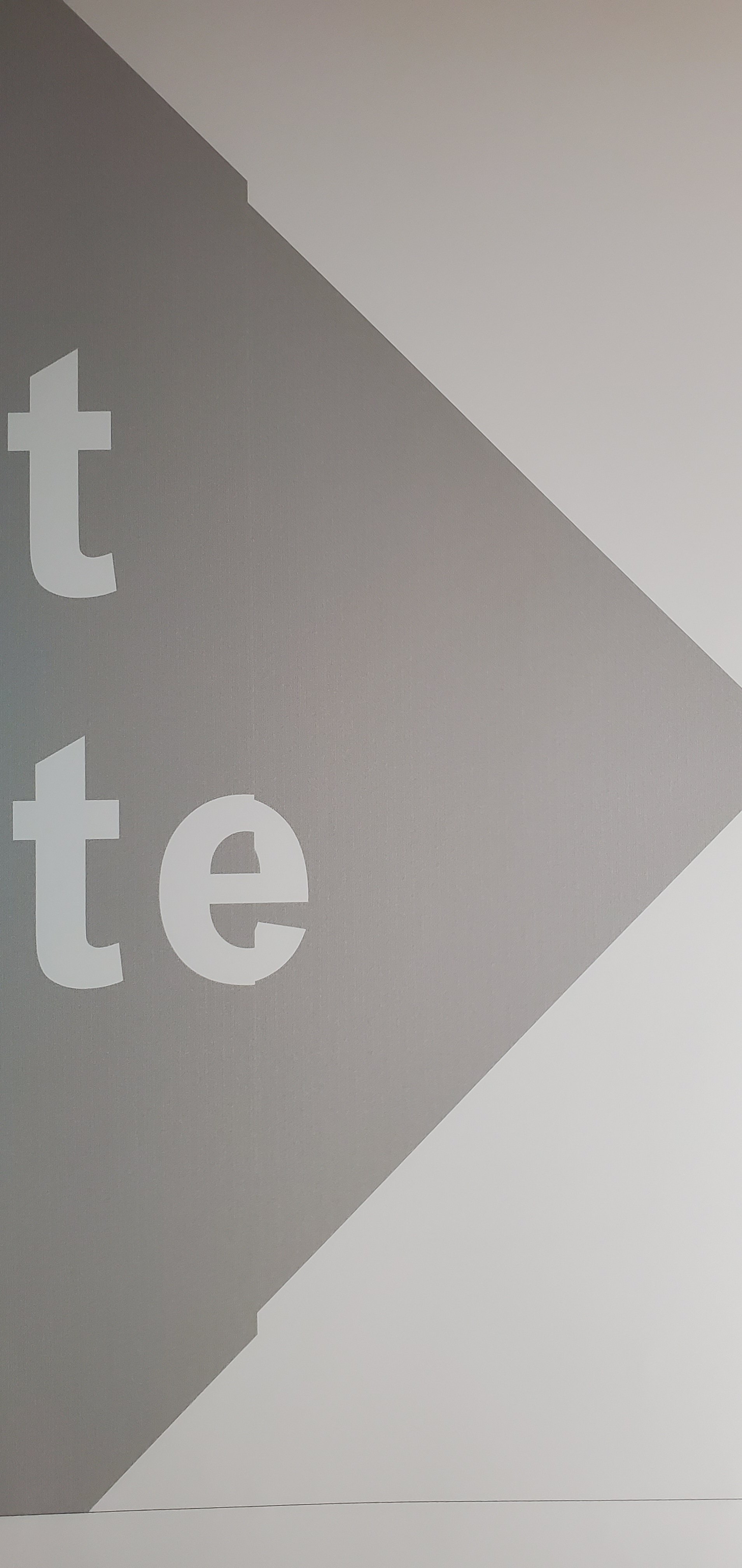

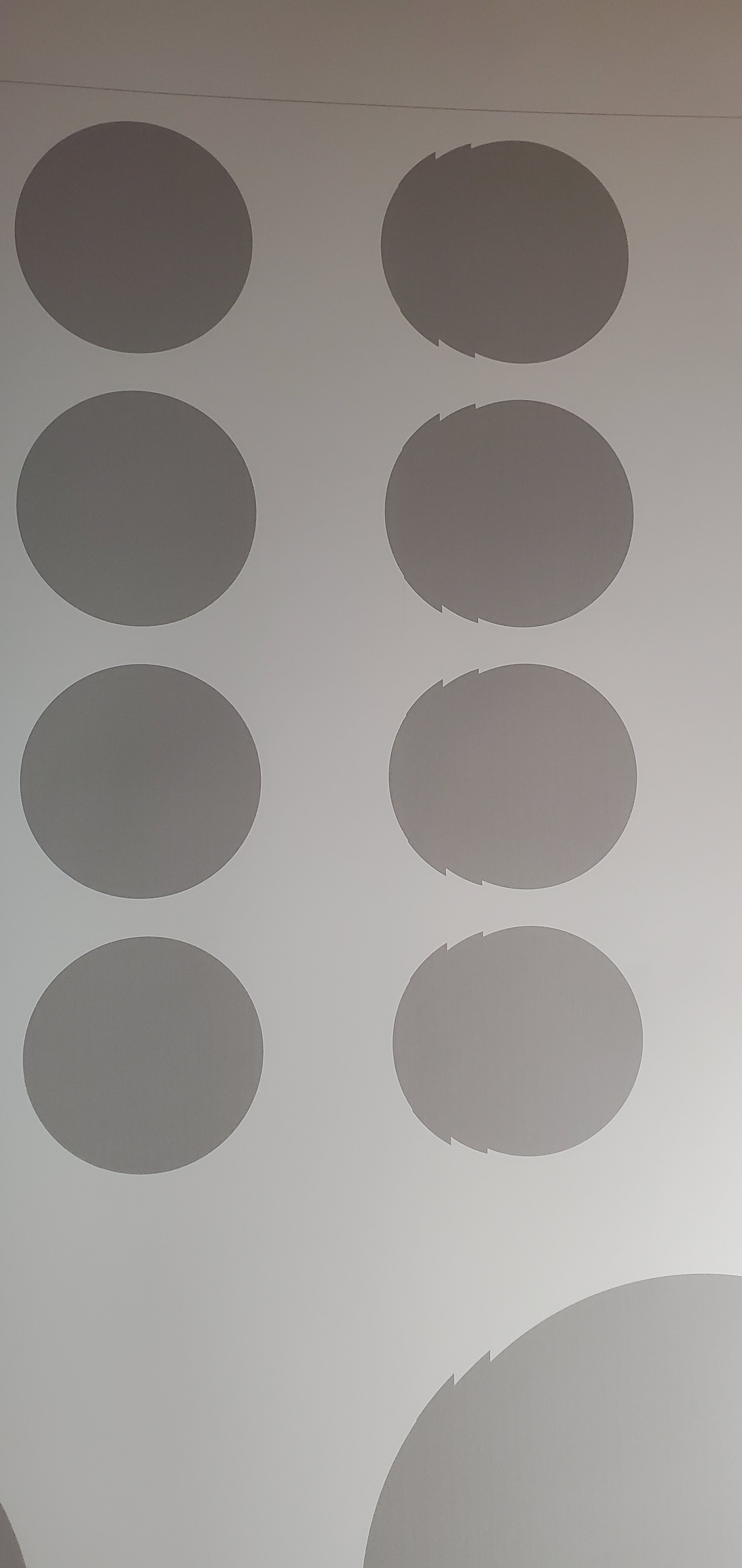

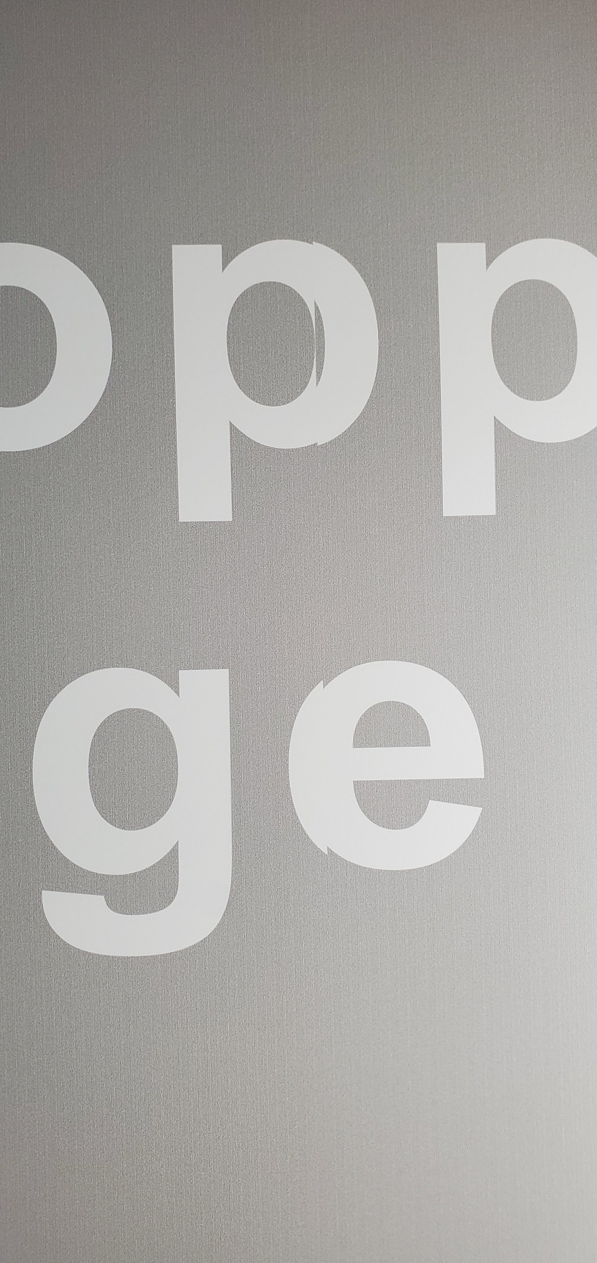

Has anyone got an clue as to what is causing this? I'm using Flexi and production manager and printing to Mutoh VJ 1204. Seems to happen more towards the end of the print.

If you are referring to the "Steps"?
I have had this before, It is Noise from a hidden layer in the Art, and sometimes
removing it can be a pure B 'ish!
Go to the drawing board and with the selection pointer click and drao the pointer so that it captures
the individual image. You should then see EVERY Vectored Path. zoom into the problematic area and
Identify the object. If you can not determine Exactly then then turn off the Fills so you see only the paths.
Sometimes the pat tool can be useful to click a point and start deleting noisy layer.
Now that you have identified, you must be very careful here.
Zoom out a bit and "Show Fills". Select the layer that is causing the issue and delete it.

Another way of doing this in Illustrator, but not exact is Ctrl + Y; Non-shortcut way is View > Outline mode, some also call it wireframe.
As for OP's original post, not familiar with Mutoh's but just looking at it, it looks like it may be a pinch roller problem. Does this happen on only longer prints? Files of a specific sort? Certain Colors? Certain Material? Any more info would be beneficial.
If you think it may be the file, save it as a TIFF, this will flatten the image and layers and will take out any of those pesky hidden things.

I would clean the encoder disk behind the left side cover. It might be skipping due to a grease smudge or ink/dust build up on the disc.
