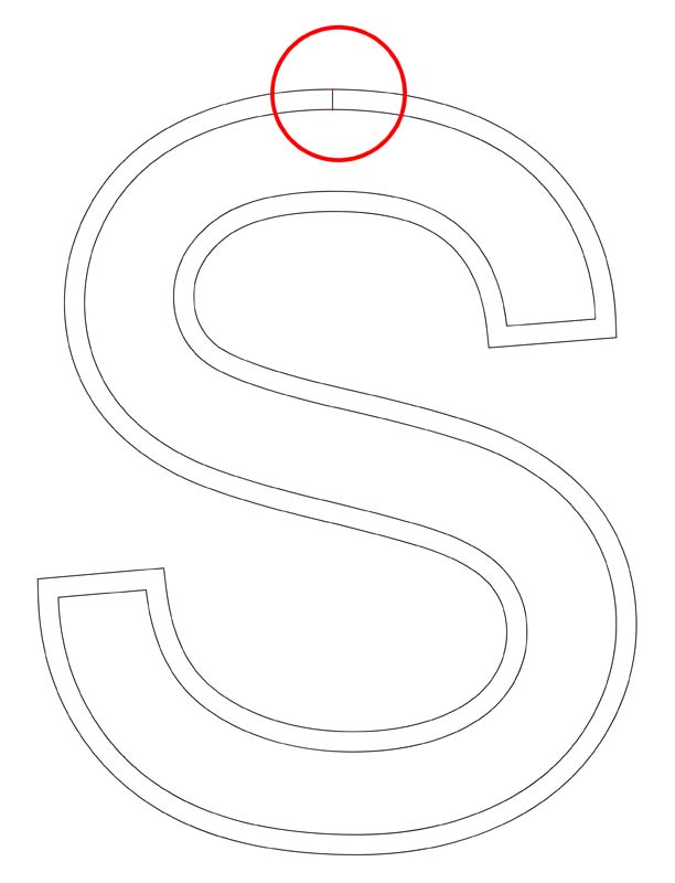

thewood
I've encountered this glitch when outlining strokes in Illustrator as well. You may not be able to separate the two paths created when converting a stroke to an outline because they are actually connected. Sometimes, you can delete the offending nodes and separate the paths.
gabagoo
your correct but with these I found no connection. In future I tell people to leave the stroke data, I will deal with it
