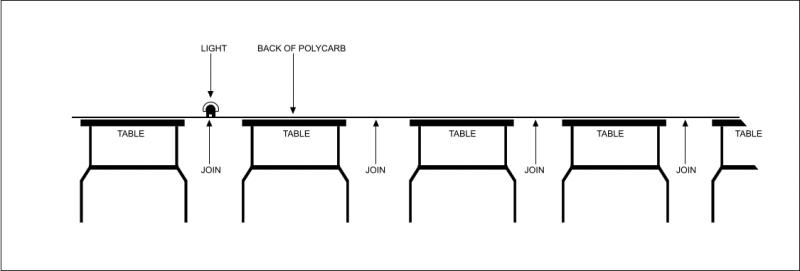

The sketch is a setup for registration, there was no room for error as you can tell by the crop of the graphic...1/8" & 1/4" pinlines running through every join all over it.
I just got under the tables ( we have about 10 of these fold up tables we use for jobs just like this) at every join helped by the back light above so I could see the patterns line up. Our light table was way to small for this job.
Taped the print in place and squeegeed them down dry.
