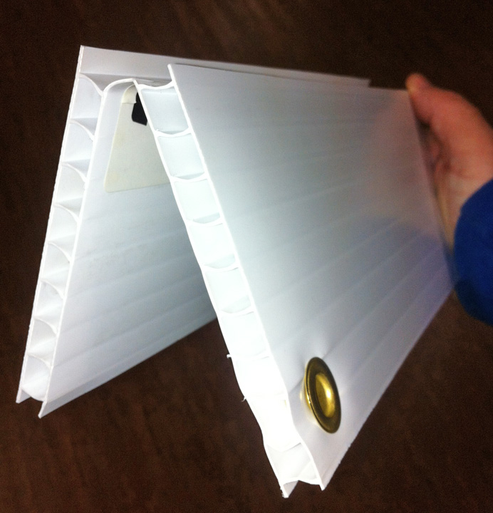

I doubt the grommets you have on hand would work. You'll need some for thicker materials.
Tom Dalton
I also recomment 10mm coroplast. You can run cable through the fultes instead of using grommets Or you could drill holes and use bannerups to strengthen the holes. The other ideas (like alumalite) would also be fine.
