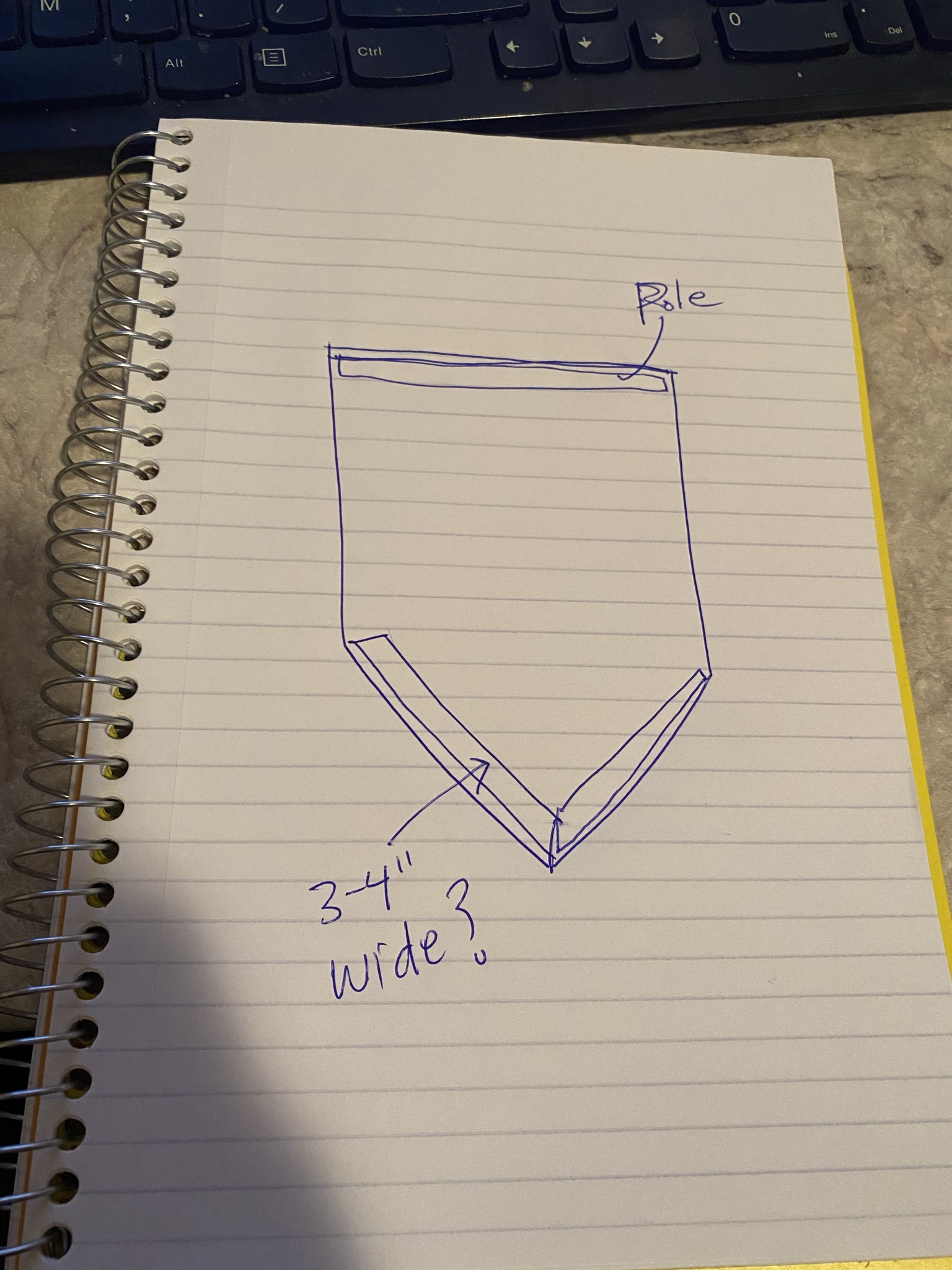

Billct2 they are hemmed and 2 grommets on top. The hems on the sample are coming apart, very cheaply made banners. It might be possible to add a pipe of some sort to the top. When you say add pvc strips, do you mean something like this?
Would the consensus be that using 4mm coroplast on the back would not work? If I bought 5'x10' it would be 2 quick cuts and banner tape.

They sew metal weights in the bottom hem of curtains to keep them hanging straight. I would not trust banner tape holding coroplast to banner material.
Without something strong back there, it will eventually bow, also. The way the weight is centered, using banner material will always curl. Perhaps you could suggest starting over and using gatorboard or something that won't bend.

I think some kind of dowel or pvc on top and on the pennants is going to be the best route, and the cheapest.
Billct2
What you showed it what I was thinking. I just think it's cheaper and simpler than trying to mount the whole banner on something like coro, but I would make the strips about an inch. Sounds
like the banners weren't specified for the application and poorly made at that

You are right, that is the route I'm going. Thanks for your help and being patient!
