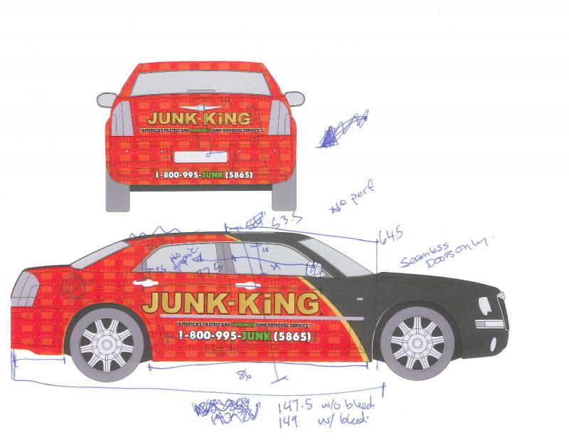

Once you "Learn" How to design - you then have to learn how to layout vehicles. It's not as easy as some may thing. You have to make sure you miss certain areas, like door handles, and large gaps.. trim, customer may want exposed.
See attached for a typical drawing on a proof to establish where to place things.
