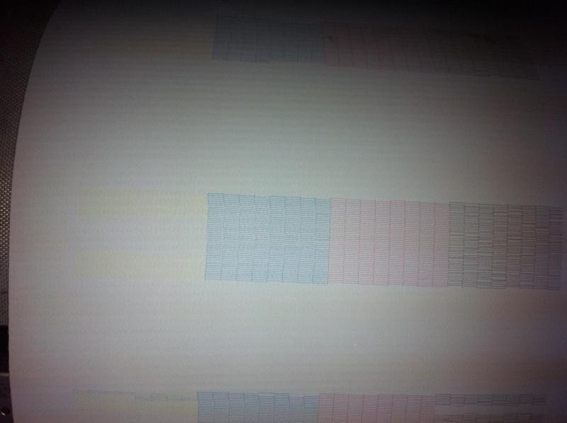

there is a missing lins in the yellow test print it only print half , in the horizontal ?
made 99 min nozzel wash
clean around the heds
change the lines under the caping , but the problem remain in the yellow
sp2 130
bulk system
triangel ink

Could it be air issu it strated when i run out of yellow then i the 6 lines missing it the test print(yellow)
Then i made fill up and look what happed
Is it true that fill up can help realease air from the system?
Anyway i saw u can realeas air frome the damper ,looks risky to me..
ravitan
Could it be air issu, it strat when i run out of yellow in my bulk ink system then i got around 6 lines missing in the test print(yellow).
Then i made fill up ink and half of the yellow is missing
I want to pull some air from the system
Anyway i saw u can realeas air frome the damper area haw do i do that?
I pulled a good amount of yellow from the pumps zone , no change so far..

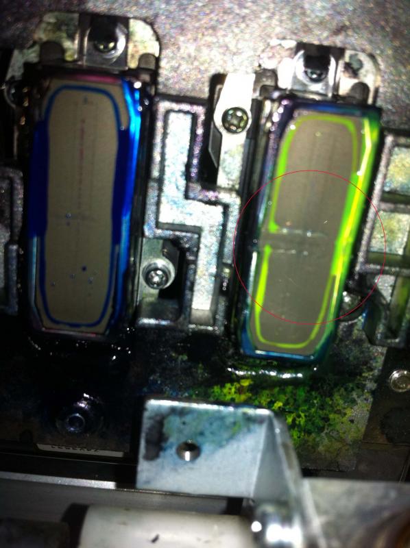

what could have happened is that your capping station screws hit the head. the blank center of the yellow indicated where the screw is pull the cover off the left side and slide the head over and take a peak. do you keep you head on thick or thin?
MikePro
head strike I'd imagine. your head is fried.
take a peek underneath and you'll most likely fine a scratch across the center of the printhead.

missing centers to test prints can be a clogged head manifold. do the missing lines move around? or is it the same pattern always?

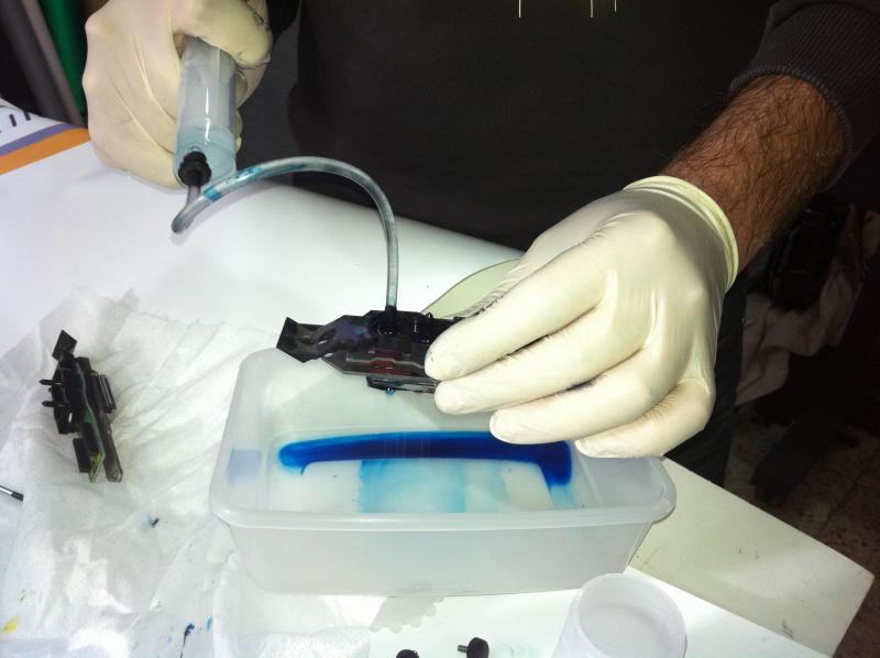

As others have said look for a scratch under the head if it looks good could just be clogged. Your black head could be cleaned up and may recover some of those missing nozzles not sure since it been clogged for so long.
Here is what I would do if there is no scratch.
Do this to the black head as well may help recover the missing nozzles.
I have a JV3 and use triangle ink as well.
what I do when missing nozzles is remove the dampner and get a syringe full of flush move the carriage over and fold up a paper towel and set in on the wipper rails now push the carriage over until the head you are going to clean is over the paper towel now take the syring with a piece of tubing that fits the nipple the dampner goeas on (its the same size as the pump lines) put the tube on the nipple and push the flush through the head. I look under the head while doing this and apply enough pressure to get a stream (just enough pressure to get a stream) coming from the nozzles Iwill do this for at least 1 but usually 2 or 3 syringe fulls (I use a 3cc syringe I think its 3 cc) pull the paper towel out and replace after every syringe.
Put dampner back on and do ink fill.
This usually will clear up most of the nozzles if you do it as soon as the nozzles become clogged.
This works for me but I take no responsibility for any damage you cause.
on really bad heads I do the same thing but with an electric pump and I run the pump for 10 min or more with the head removed from the printer (with the pump setup you can see when the nozzles become unclogged and if they dont clear up after 3 or 4 10 min cycles they usually wont clear up). I had a head that looked worse than your black head and built this pump system and cleaned it and recovered the head to only 3 missing nozzles and have saved myself at least 3 heads since I built it.
Good luck
and if you do the syringe thing remember only enough pressure to get a steady stream coming from the nozzles.

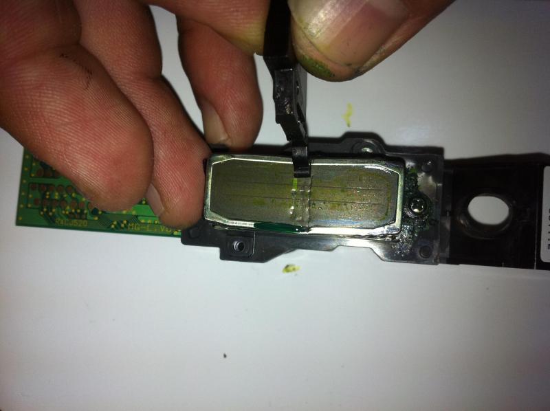

ravitan
jpg is attach
it looks like a scratch from the middel of the head to the left side
i wonder what made this one , since the scratch start in the middel and ends in the left side of the head (i print thick all the time) could not cose from the capping

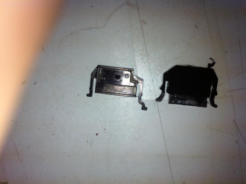

could be the new wiper holder whith one arm longer .in the jpg its the one white no wiper in it. i got for free from the ink supplier
afther a weekend i saw the machin whith no wiper (which i found later..insid somewere..) the wiper released frome the holder
i dont know way.
the thec guy is on his way whith a new head (1050$ not includ work which i estimat around 200$ aawwochhhhhh)

SARTampaBay
Ouch. Never seen a wiper holder like that. Oddly the mark on the head looks a little like a capping plate to me. Are those still in place?

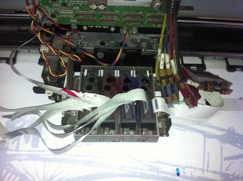

ravitan
the techman was hear
he saw the scratch which thake place in 2 heads and replace bothe of them..
his said that it mite couse from the paper that sumtimies jammed or going up and toche the heads
leater on when he removed the heads i comper the scratch to the wiper holder
jpg is attach.
we mixed the heds location
the new loctions
k=new
m=was good
c=refresh the black and put it in cyan (no big improvment but prit fine..)
y=new
naw im going to try to reduce the costs becouse of the wiped holder that i got
i got it whith jv3 wiper in it, inside triangel ink (solvet inks for mimaki jv3)
attached some beuty shoots as well
