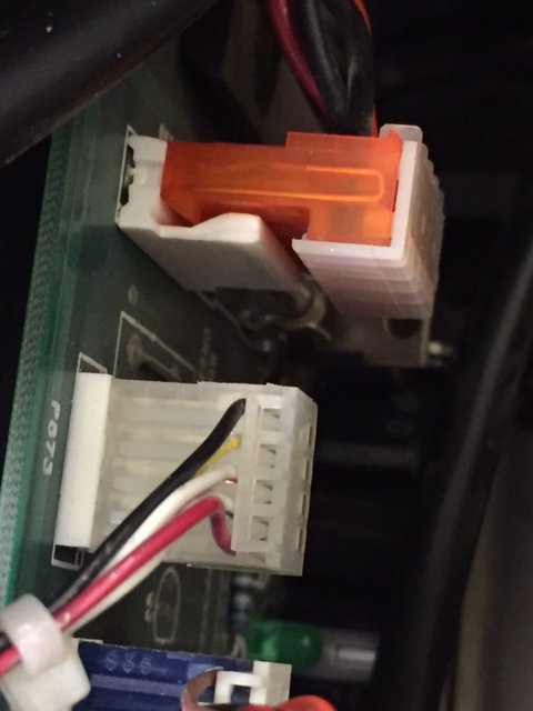

Flipped it over only this time I did not unhook the power, just turned it off. I opened the side and pushed on one thing at a time and then turned the power on to see....well the first thing I touched seem to do the trick and it did feel a little loose. Posting a pic of the culprit and maybe if someone can tell me what this is and does and more importantly how does it fit together...I was to afraid to try and force it to see how it connected. It is the orange and white piece...

sorry for the very late reply. that is a molex plug. my guess would be that there is a bad solder connection on the printed circuit board. this would be fixed by getting someone to resolder the connectors (i would do them all if i took the board out of the machine)
you can take the board to a tv repair shop or someone with soldering experience in your area. the boatd should be cleaned. with 91% alcohol or flux remover. after soldering.
the
problem is rarely the wire end of the connector.
pm me if you like, we can discuss further

oddly enough, since discovering this was the culprit and making sure it was snug, the beeping has stopped since I posted this....thank you
