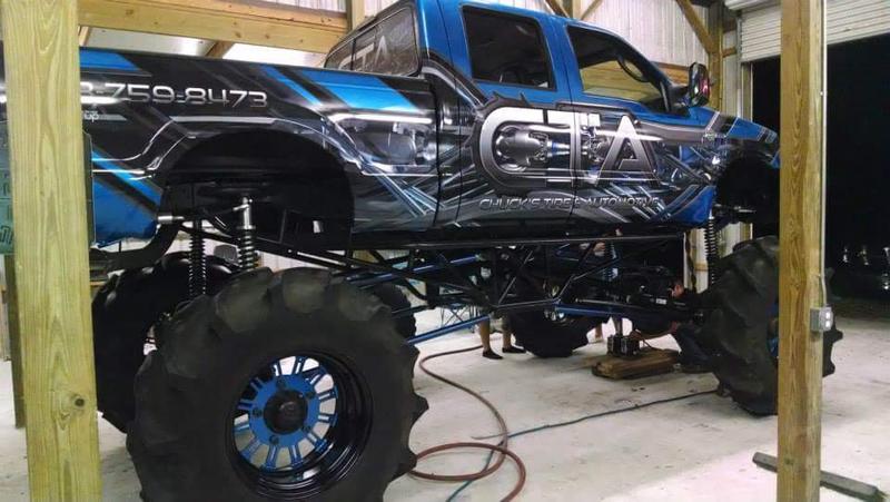

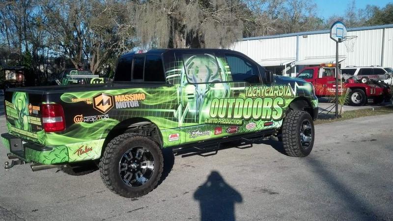

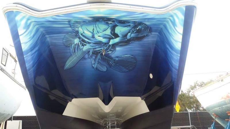

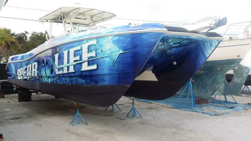

I bought that printer and cutter when I first started my business and I worked the heck out of the printer for 5 years before the head went bad. I recently thought I was up grading to a Roland xr 640 and it was the worst mistake of my life! That little $8,000 Mutoh printed circles around my $25,000 xr 640. When the Roland works it is fast as hell but I have to print stuff 2 or 3 time and waste a ton of materials, it is over priced junk in my opinion. The Mutoh is not a speed demon, it is going to take 4-5 hours for a little car and 7-8 hours for a full size van to print. I would recommend it in a heartbeat. The Q54 is a beast, it is based off the graphtec and it will cut circles around my P.O.S Roland ! No exaggeration, my Q54 will do the same amout of work in 4 hours as my Roland can do in two days! You do have to be careful with sign warehouse because they are a little misleading or they were with me anyway. This was the first time I had bought and leased equipment so I was a rookie and they got me. In the lease they said there was a percentage buy out, when I asked what it was they expanded to me that it was just $1.00, when the lease was up my $1.00 turned into almost $3000.00. At the end of the day it was my fault, I should have had an attorney look at the lease for me, it would have saved me a ton of money. If you do have any problems with the machine you will have to ship it back to TX in the orginal box it came in, so keep them in a safe place because they charge you 400.00 for an orginal box to pack it in to ship it back. You will not get any one on one training, you get thrown to the wolves. They give you free phone support for a month or so then it's like 50.00 per call. At the end of the day I would by another machine from them but I would not use there finance company, I would call someone like Geniva Capital they had much better rates with a true $1.00 buy our option. I have attached a couple of pics so you can see the print quality. These are all after the printer was at least 3 years old or older with the orginal head!
As far as cost go I'm not sure what it would cost to print on the Oracal, I used it one time and wasn't fond of it. I use the 3m 180cv3 with the 8518 and I was around $3 + or - a sf.
Those prices you got quoted are in the best case scenario with the lowest ink consumption and zero wast on materials! Like I said they are a little misleading!
