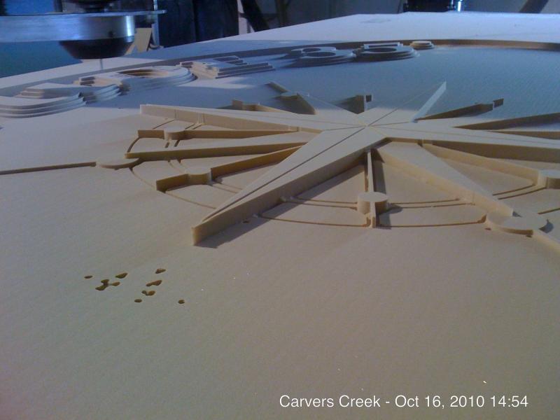

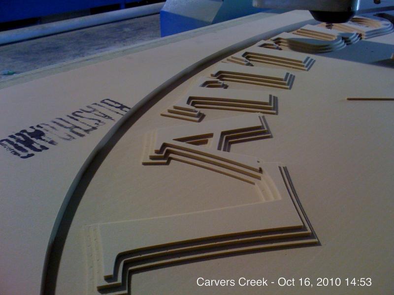

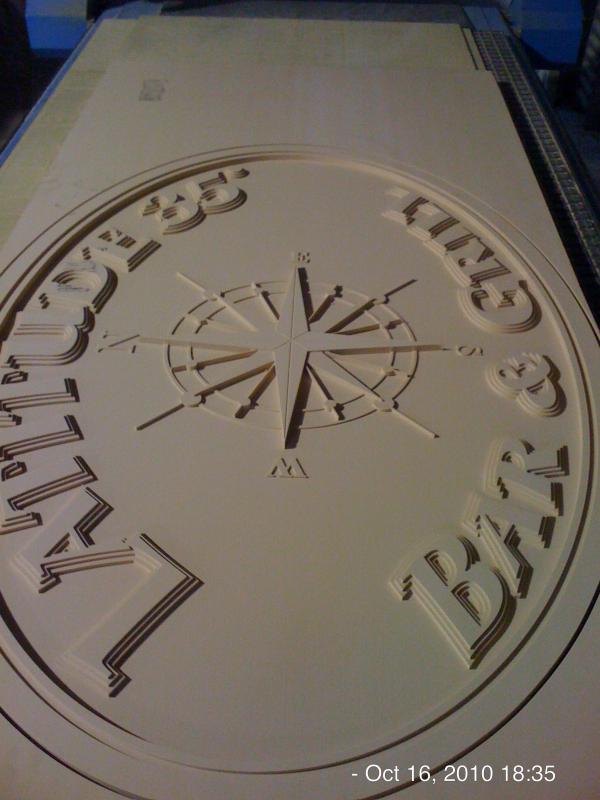

Started at 8 this morning. Did 4 hrs of it yesterday... I'm going home now lol

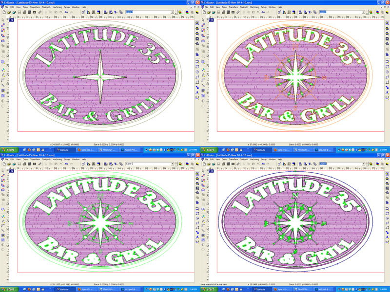

4 layers, almost an hour to set up the file (still learning)

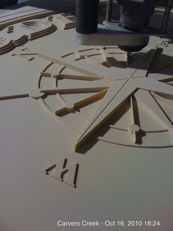

Fitch
Great looking so far.
However I would have liked to see the North, South, East, West raised more than the sub points (NW, NE, SE, SW) and each point chamfered on an angle. Would have added just that little more dimension and definately more "excitement" when moving past the image rather than just a raised 2D image.
Cheers - G

I have to agree it could use some more depth with angles instead of the steps. This may be the limit to my knowledge at this point. Was trying to figure out how to use a V bit to produce more depth and dimension but just haven't had the time to "play". I wish this router would "carve" as was promised, but it just won't do it, and I may be limited by the basic version of Enroute I have to use.
I would truely appreciate any advice, comments, or points and jeers.

Routerguy
Cool looking sign. Next time offset the letters as a group and just run a router offset toolpath at the two top depths then do the island fill for the last depth should eliminate a couple hours of run.

SignManiac
Break your design down to three or more layers before hand. Think background, middle ground, foreground. Don't limit yourself to one sheet/thickness of material. Use multiple materials built up and go for super-dimensional. It sells for more!
