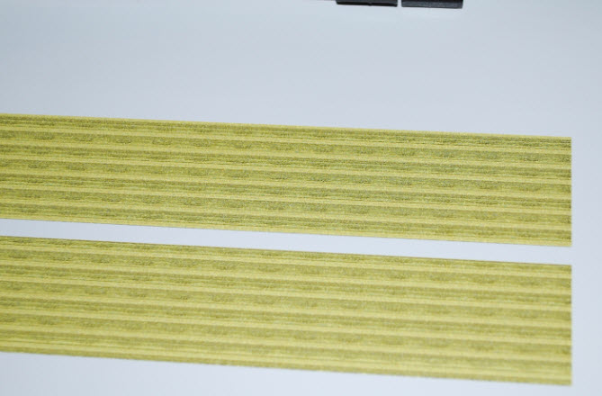

One day all is well, the next day the thing is banding like crazy. (see photo 1)

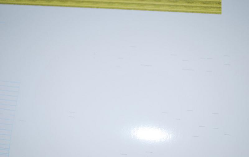

So, I park the head on the left, get out the swabs & scare off the dust bunnies... everything looks ok. Until I print a nozzle check. 95% of one black is missing, 50% of the OTHER black, and maybe 10% of the cyan.
OK.. after 5-6 strong cleanings the problem is WORSE! (photo 3 Nozzle Check)

The yellow bars are actually 40-30-20-100 "rich black" test prints (Photo 2)

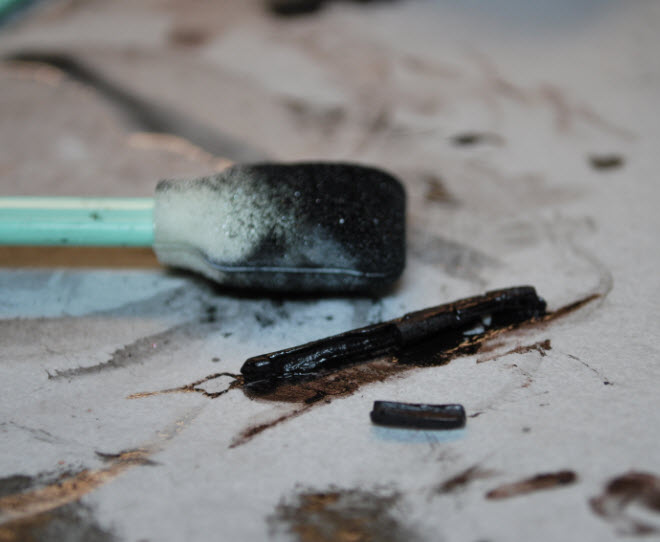

Well, before dropping a few hundos on a maintenance station I thought I would take a crack at fixing the old one. In one of my past lives I was a printer/pc/lan tech weenie so I have a bunch of experience fixing printers.... just not these giant inkjets.
Turns out the maintenance station was filthy and completely gummed up. I pulled it out of the printer and cleaned it up on my workbench. I discovered one of the pump lines was completely blocked... see photo! That black worm looking thing next to the swab is dried up ink that was in one of the pump lines!
After a good cleaning I now have a perfect nozzle check!
