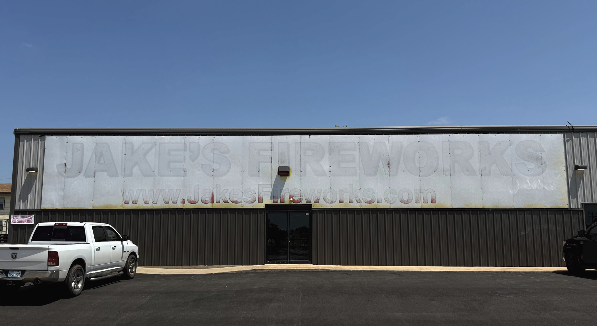

Jake's Fireworks requested that I re-do a sign at one of their locations, and sent "this" material to their store. I assume it's a really basic calendared film.

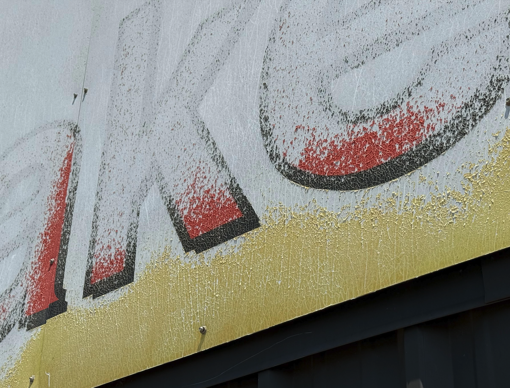

I don't think there's a way to recover these old panels (8 years old). They're terrible.

i'd prefer new panels too, but if you want to save some cost for the client you can just upcharge the labor needed to remove/regraphic/reinstall
might be able to simply apply new graphics to the backside of the existing panels, and just hit both sides of the holes with a countersink before beating up your rollertable.
...assuming the panels are flat enough to salvage, of course.
The panels SHOULD not be re-used, as it is kaput. I have never used supplied vinyls or substrates. You cannot control the quality, therefore unless they only need a 3 month guarantee, step a side and let someone else do it.
A different approach would be to just do a face lift in your shop on new acm panels, build a small frame of wood on the existing signs, missing all the screws and mounting to it, if the old panels can take the added weight. What weight/thickness are the original panels ?? I wouldn't use any less than 6mm or you'll have waves.

that vinyl is 5year Intermediate. Judging by the UV damage to the existing panels, I would say it will need to be replaced in 5 years and it will be cracked and baked dead. Vinyl will stick to the aluminum sides of the panels - just need to clean with Windex and follow with Isopropyl Alcohol to remove any waxes, oils, grease. Problems I have with the job include the mess this will make on your RollsRoller table, the cutout for the light not being symmetrical, and warrantying the work. I get that they want to do this on the cheap, but looks like the sign will have to endure the harshest of UV conditions. At the very least, I would use a polymeric Intermediate with a Cast UV laminate. Briteline CastWrap gloss UV laminate is actually pretty good and is a 7 year product (supposedly a 3M). Grimco - doesn't make their own vinyl, but instead has brand agreements to use Arlon and 3M materials (maybe others), much like aftermarket car suspension parts are mostly all made by one company and branded differently.

Rule is not to reuse faces like that. I tell them it will cost you more for me to reuse them and you won't get a warranty. Sometimes I will on polycarb that's not too old and could come off easy.. but that sign is trash.
Like others mentioned, a cast print and overlam will last a little longer, but he just needs to plan on replacing the thing every 5-7 years. Set the expectation. That's a lot of panels, price it well.

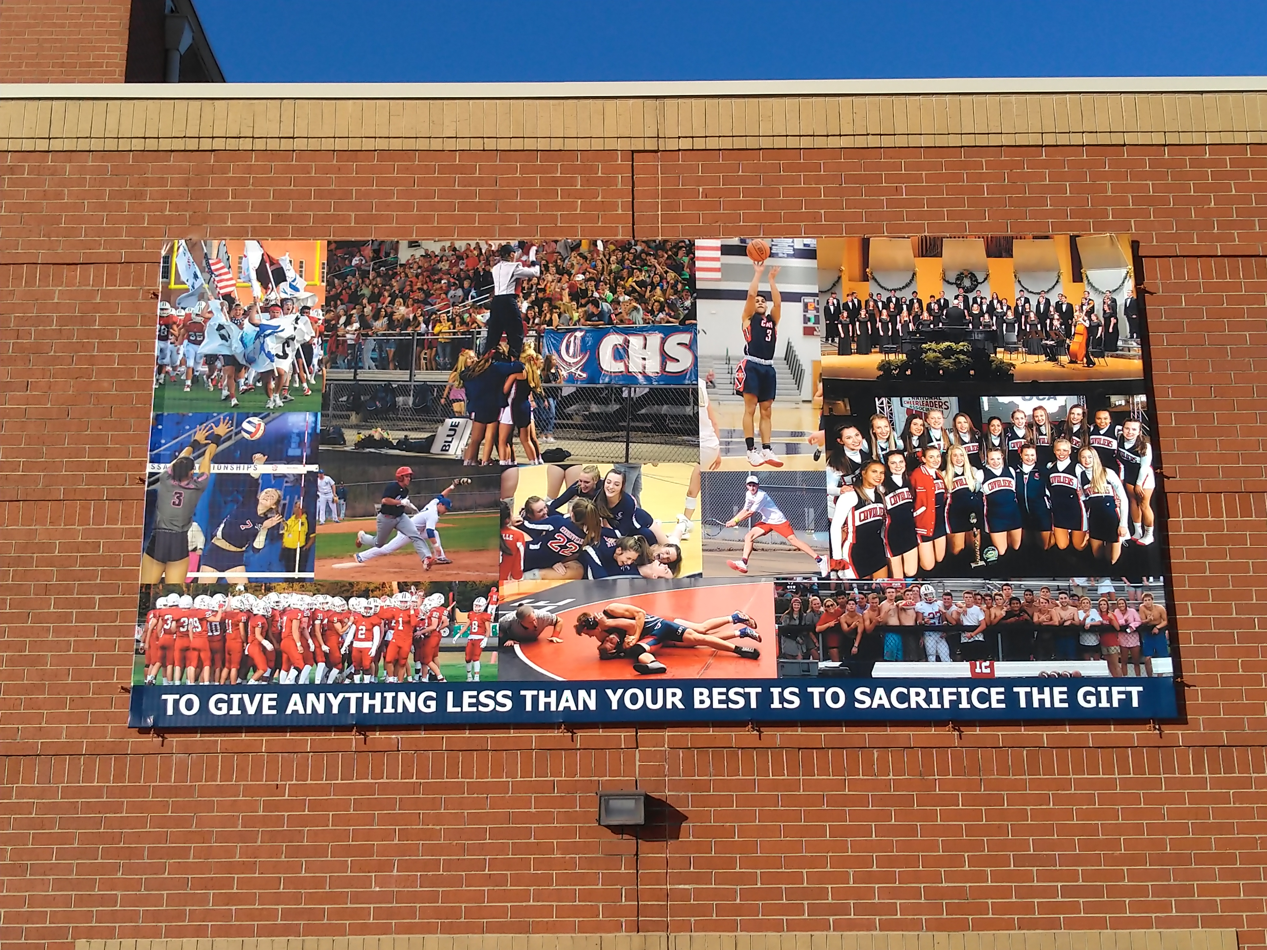

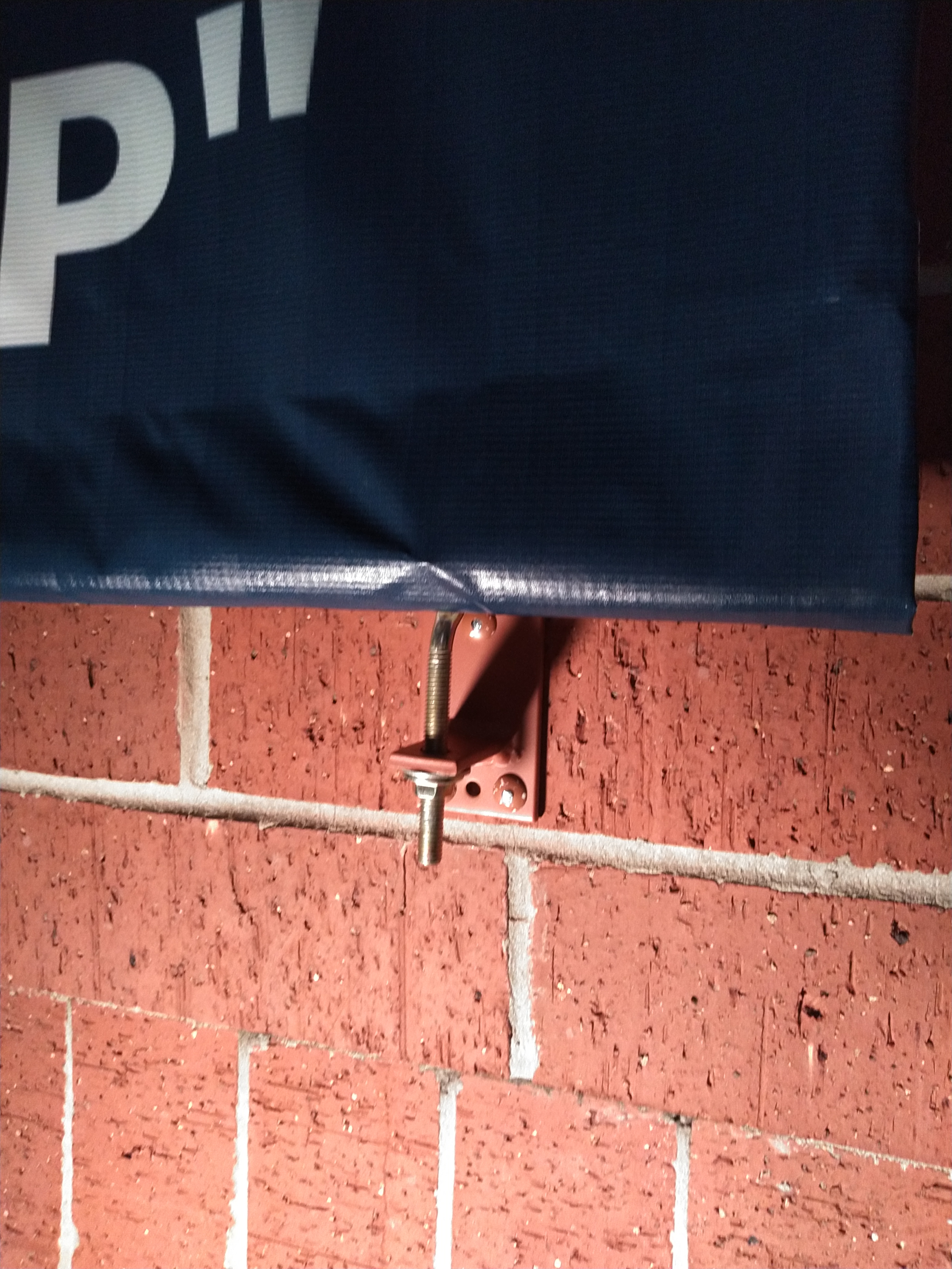

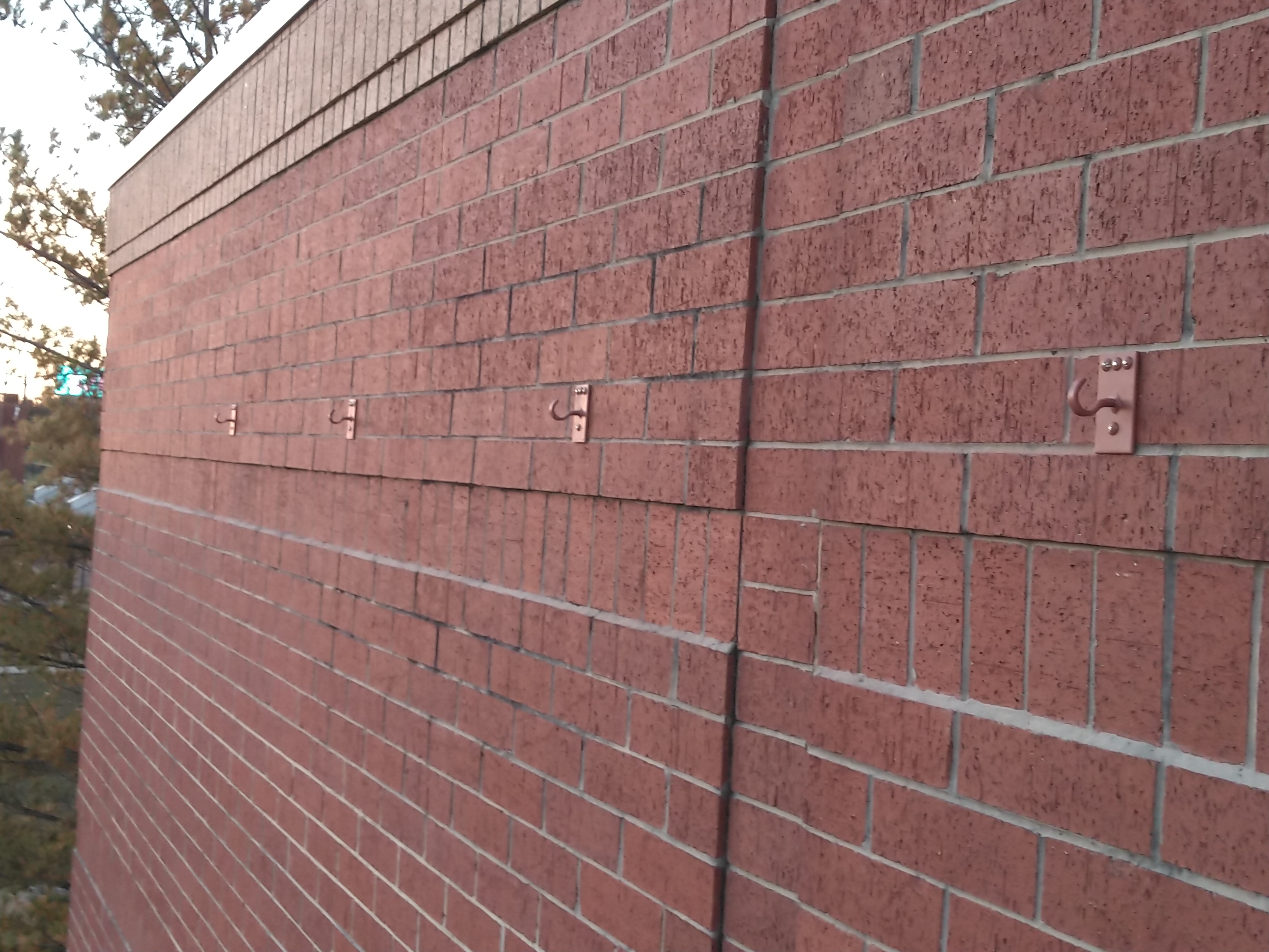

I would recommend a frame to secure a billboard vinyl flex with pole pockets. Good for 4-5 years at a fraction of the cost. Easily change out when it's faded. You would need to remove the wall pack fixture or whatever that is over the door and reinstall after the sign install. The picks are my own design and fab but Formetco & Ackland Frames both have ready made systems for a project of this size. Circle Graphics or any other specialized large format wholesaler could do your printing.
