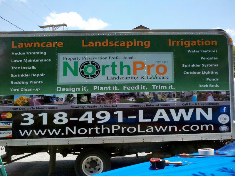

Flubber
one side down.....whew!!!! that wasnt as bad as i thought it would be...
