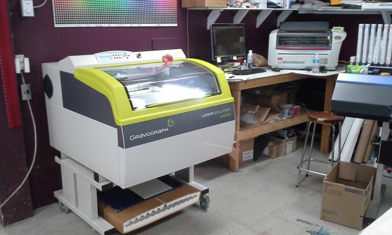

Finally got it all set up :thumb: (Apple for scale, already ate the banana)
Have both machines running today ... Sure is sweet!
Thank you all for you thoughts. It did play a factor on my final decision. :toasting:
