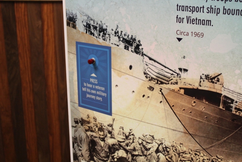

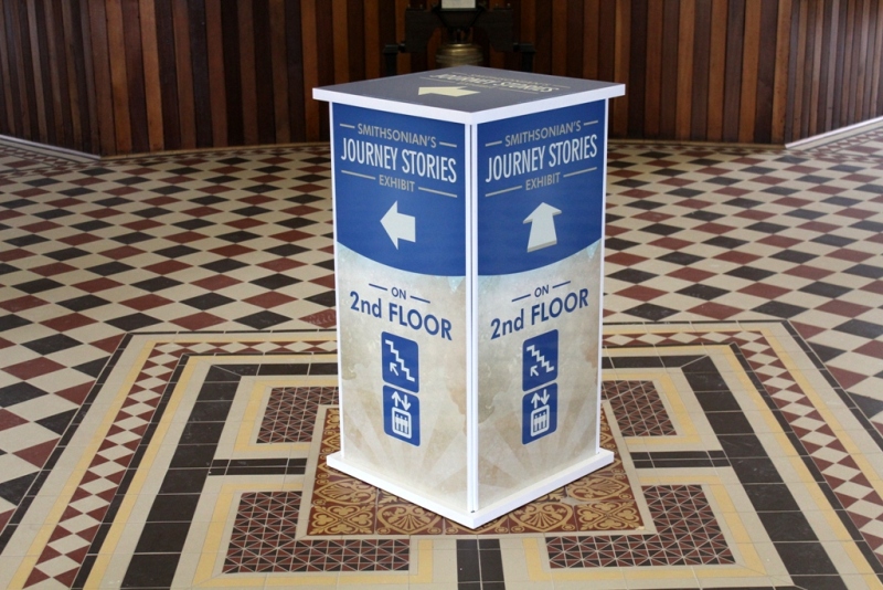

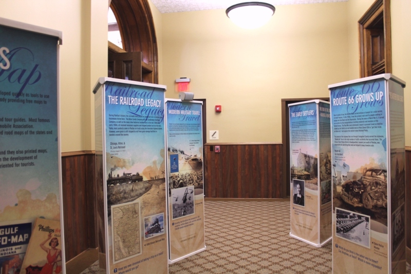

We made these for a traveling Smithsonian exhibit. The bases are PVC. The panels are alupanel. The bases have routed slots in them. No extra hardware needed. All you do is snap the whole thing together. It comes apart easy when you want to store or move it too. Not sure it would work with foam core though.
