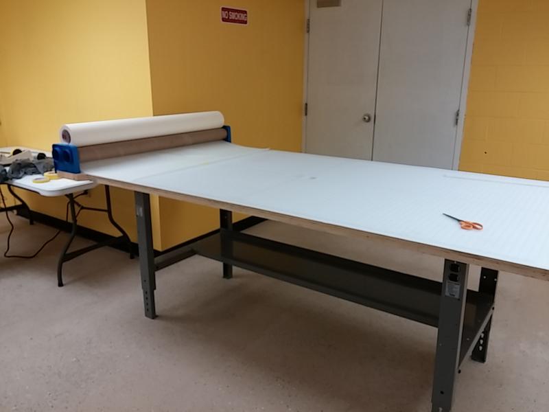

We are going to need tape and ship decals that are around 5 feet long and are cut from 48" 3M 680 reflective vinyl.
We just moved to an area thats letting us build and use tables bigger than 30" by 6 feet.
We have a 4' by 8' and a 4' by 12'. I've attached a pic of my setup. Any tips? Maybe a Big Squeegee, I've used a shorter one before we had a laminator.
The only way I can do this by myself is to wrap some of the tape around a 54" tube and use that as sort of a handle. I guess two people would help but thats not always possible.
Of course I would love a ROLLSROLLER but thats not in the budget for now.
thanks

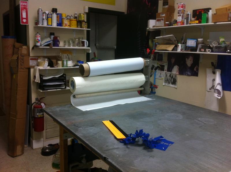

Now we use our rolls roller, however before we got it, we used to put the roll of mask on a holder so it's above the table (see attached pic) pull off enough to cover your graphic, plus a few extra feet, stick the mask to the table and start squeegeeing!
If you have more than 5 to do, it's worth the 5 minutes to web up the laminator!
