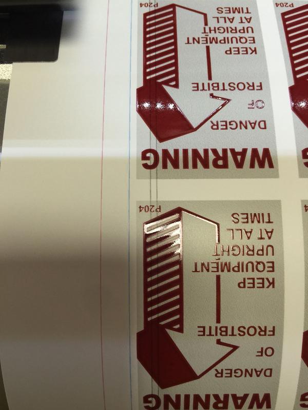

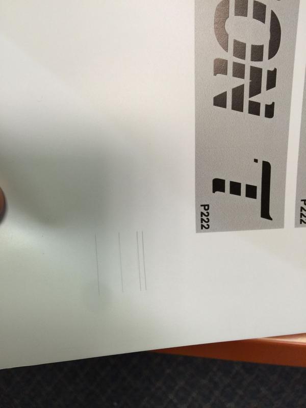

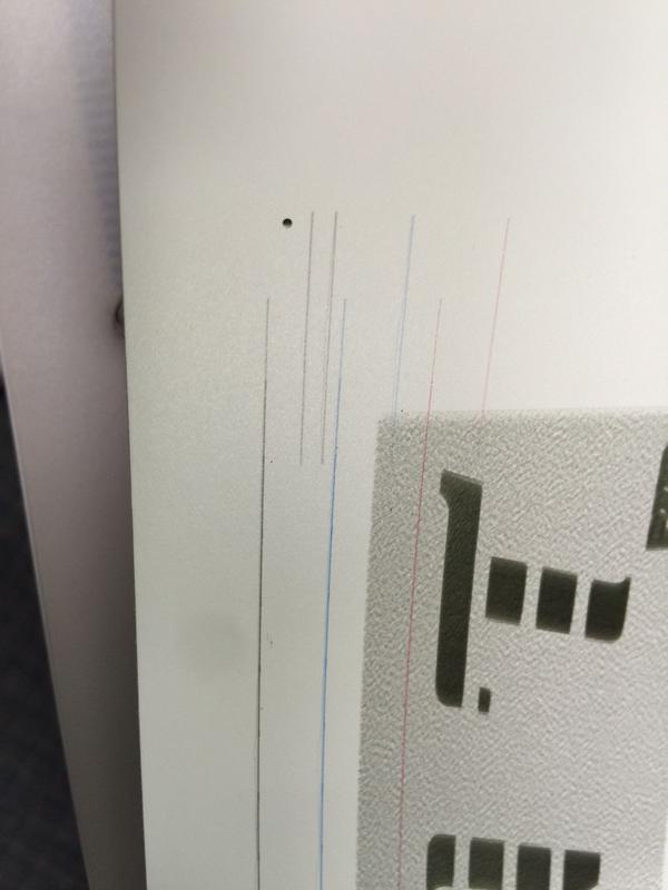

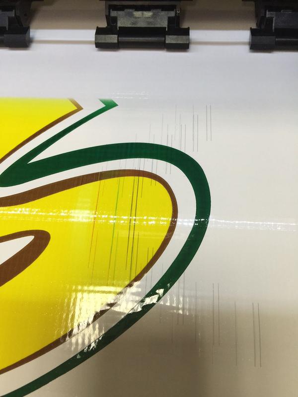

I'm getting these random lines on my TJet 1671 with a DX7 head. The are not uniform at all as far as where they show up. Most of the time they are on the edge of the print, sometimes they are just outside the print area, and this time they ran right through part of the print.
I am running the MainTop software. It has happened on both types of media I run through it. Banner material and 3M vinyl.

I just bumped the file over in the rip and the lines followed with the movement. It was happening right above a certain letter and with the movement it is still happening over that letter.

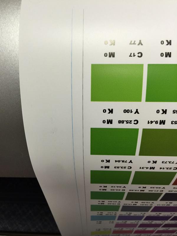

In the 2 pictures I'm attaching here you can see that when I put something printable somewhat close to the edge of the media it prints the lines all the way through the whole print.
If I take a copy away from each edge the lines print for a second and then they stop when the printing starts.
