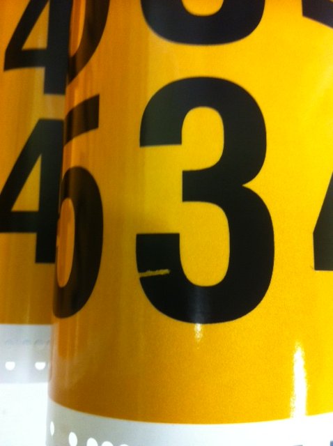

I would love to know what causes this awful print to happen on my edge le. This particular one is on yellow reflective. It appears in nearly all the bottom numbers and can occur at the top as well. I am running Duracoat super opaque black. I think it is the edges of the foil curling up or something physical rather than a printer issue. Anyone else see this happen...take a look

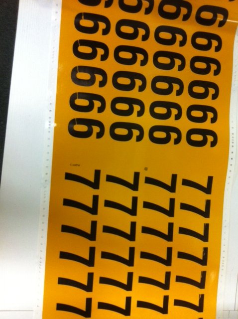

here is another one...this time it got the bottom ones and the next print it got the top ones!!! jeeeez
Billct2
When I see that it's usually the foil messing up. Not sure if Pat's suggestion would help, but doesn't Duracoat say to use a lower heat setting than Gerber.

A black sharpie might fix it as far as the look, but that's all fine and dandy if you like giving your customers inferior quality goods. A black sharpie will fade within 1 week outside in the sun. These numbers go on hydro boxes and usually are on forever.

Try lowering the heat setting and see if it helps. I've had that happen before and I (think) that helped...... it's been a while.
Yes it is true that Duracoat can run at lower temps and usually I do. On that last run I actually increased the temp hoping it would help, but only made it worse...lowering all the way to print more. Man I hate screwing up reflective $$$$
Pat is right. Lower your heat. Duracoat requires less heat, and Reflective is a high heat profile. The foil is sticking too well, which is pulling it to one side and causing the wrinkles. If you look at the foil after printing, you'll see the wrinkles.

Lie to it like stated above; tell it you are printing on regular 220 vinyl instead of 280 reflective.

Thanks guys, turned the heat down to the lowest setting and they printed perfectly.... being in a rush though, I forgot to up the cut pressure and toasted another 3 yards of reflective...is it Friday the 13th or something?
