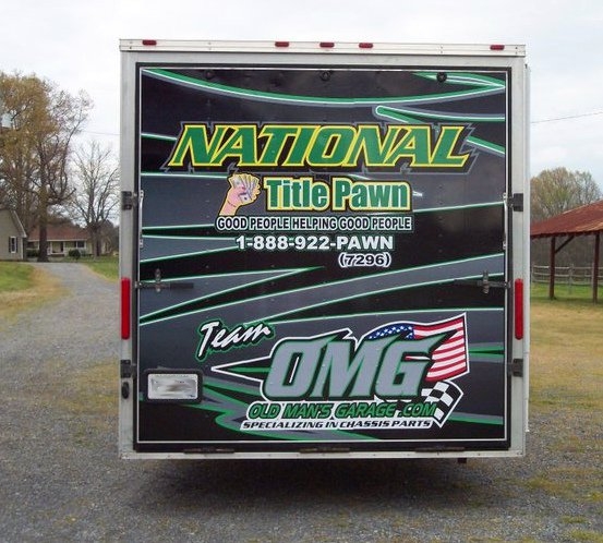

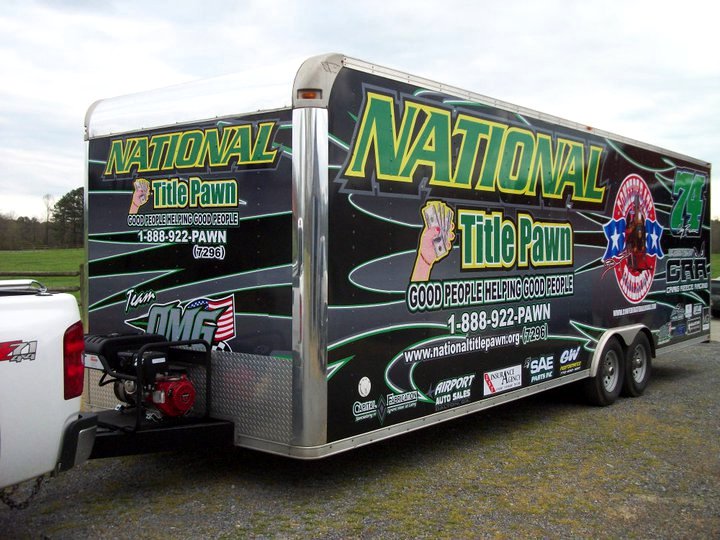

i just went thru this dilemma myself:wink: i decided on wrapping over the rivets, btw i printed this on my 30" versacamm this week.

wrap over them. use a rollipro rather than rivet brush so you dont poke holes where the screw heads are.
removing them is opening you up to failures with the trailer (leaks, etc.) and is 100% not necessary.

these guys wrap the trailer every year as they change sponsorships, so i used Oracal 3165ra and 210 lam, worked perfect!

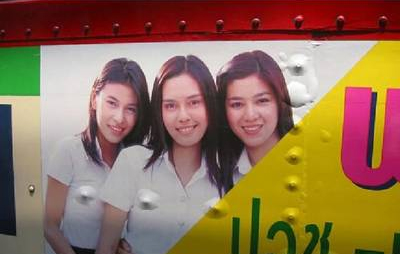

As for the screws, yes it takes more time to remove them, but IMHO, makes for a much more professional looking install, if you wrap over screws, sometimes the wrap lifts around the screws several years later (see example below).
