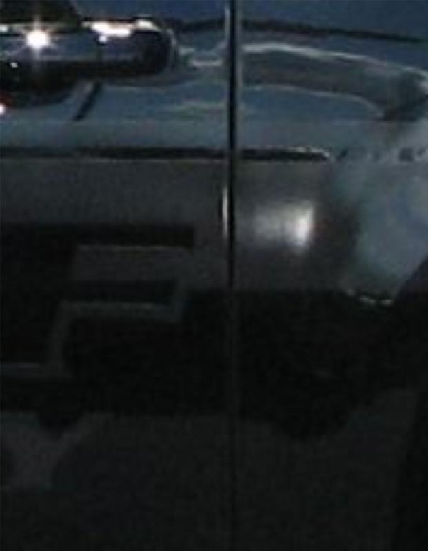

Not translucent, but transparent black. I have the opportunity to bid on a local law enforcement unit that uses quite a few ghosted vehicles. What they have looks every bit like a standard gold reflective (they have to have it reflect gold) that has been overprinted in black (vehicles are black). You can see the mottled pattern from the print in the reflection:
Now, I have no issue with trying to mimic whomever did the initial run of vehicles.. it just might take me a while to get the correct density of black and still have the gold reflect through. So then I got to thinking... is there such a thing as a transparent black vinyl that could be overlaid? I looked through all my catalogs and the only thing I found was translucent black (which, really, isn't all that translucent). Other than a window tint film - which no, I won't use - has anyone seen a transparent black film? Or, has anyone found a reflective black that has a gold tint at night? Most of my 3M's and FDC films reflect back that weird white/grey so that won't work. The only reason I'm asking is to try to "smooth" the look of a printed decal and make it more uniform.

So, without lights or a flash, under normal daylight conditions, the black just looks black, but at night when lights hit it, it reflects gold ??

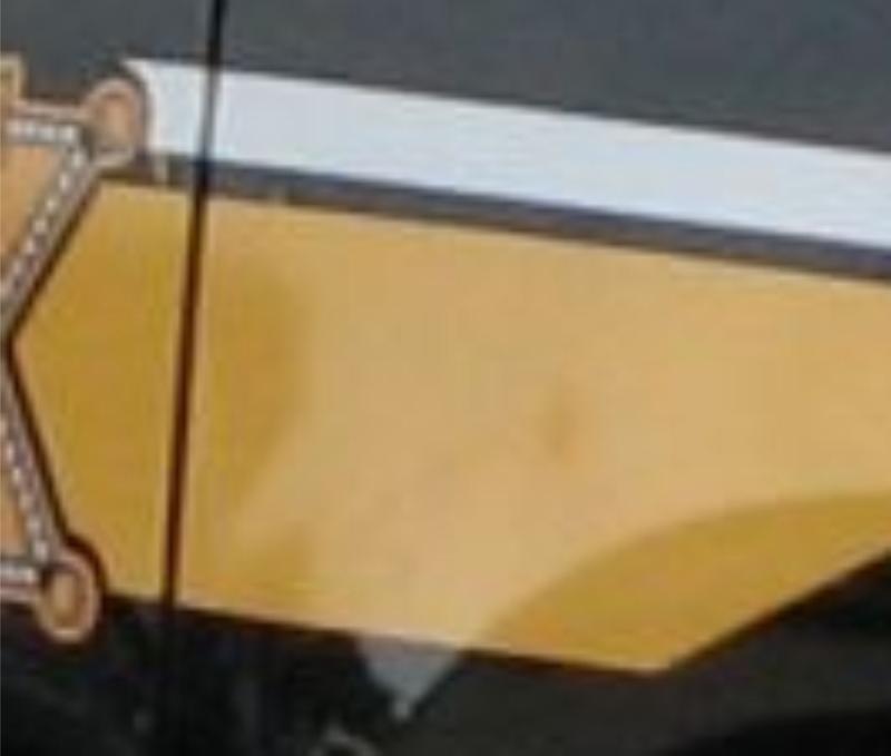

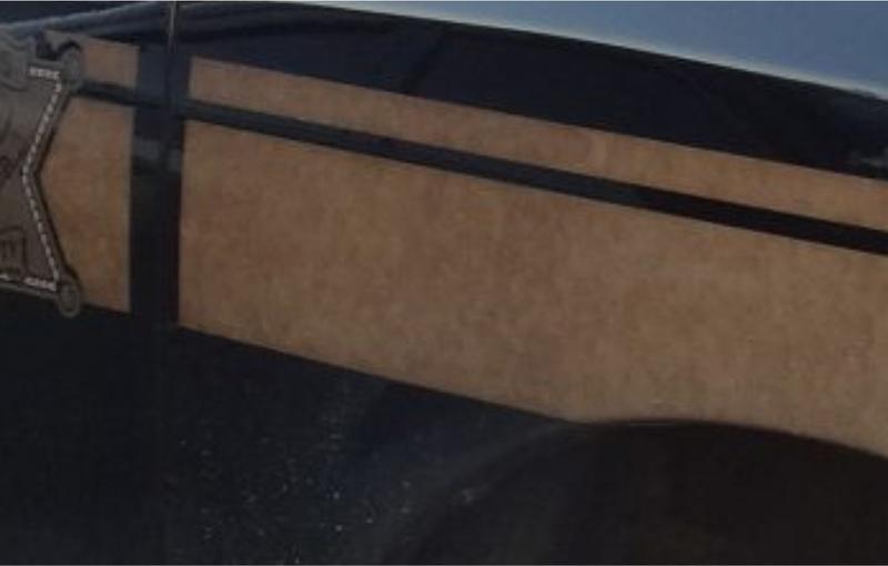

Exactly. On their non-stealth cars, they're using a standard (what appears to be) 3M 071 yellow, with a faded gold to white name for the department. The gold in the name matches 064 gold. Images below.. pulled from their website. I've seen the cars on the road, but haven't actually had the chance to put a chart to the vinyl for a match, but the numbers above seem very close.
ghost, daylight
regular marked unit

Tammie - looks like you've stumbled on the supplier of the previous installer. See how the ink is blotchy on the Vian police car? It's exactly that way on the ones I have to match. Though I don't see how they make the topcoat, screen printed can't be ruled out.. but the topcoat finish isn't as uniform as a screen print would be. Regardless, using Seller's idea, printing a yellow/gold on a white point black so far has been successful - I just have to fine tune the color... and laminate many, many feet of the stuff!
