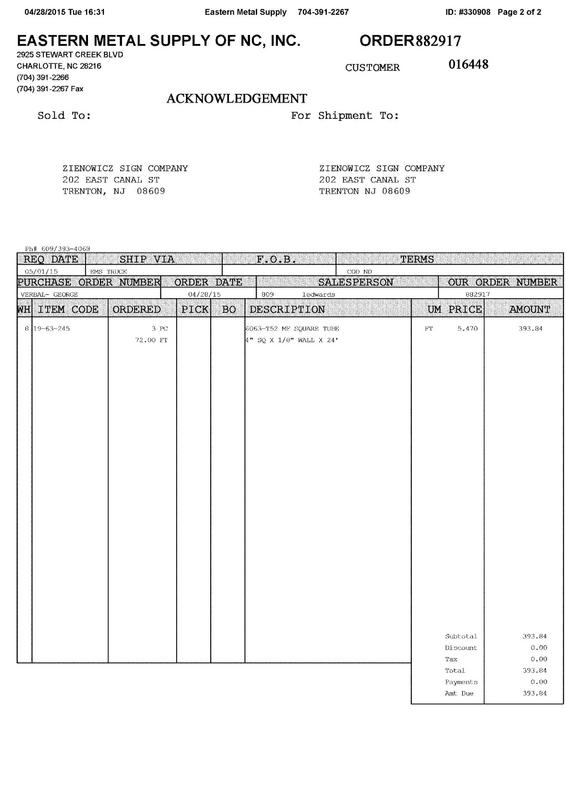

Where re are you finding a 4x4 aluminum post for that price?!? I've called around up here for this and I'm looking at around $400 for a 24' length!
what grade of aluminum are you using? All I can find is anodized, which I don't need.

same question, most of our dealers are also in the 400 range also for a 4 x 4 x 1/8 x 24' delivered

I also don't think I can get aluminum anywhere near that cheap.
And it still has to get painted.
There is a place that sells a limited selection of pre-painted white aluminum pots, but they're not cheap.
We often use steel because it's cheaper that aluminum.
But for a basic job a 4x4 PT with a sleeve cover is till quick & cheap.

Wow you guys are paying way to much.
We pay $131 for a 24' $43 for an 8'
It's about $30 for a 3" post
It's $25 for an 8' pvc plus $10 for the wood post.
Painting aluminum is not complicated.
Just ordered some today
