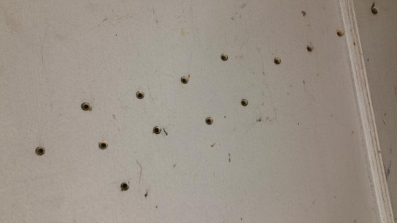

I have a sign face made of 2" thick HDU. Attached to it are 1" HDU letters. I did not make the original sign, but we have been asked to reconfigure/remove some parts of the sign and put it on a new background in a new configuration.
The letters appear to be in great shape, but I am hesitant to remove them as they could easily break. It looks to me like they were applied and screwed in from the backside of the sign. In trying to remove a small graphic element, it did not come off easy. So A) they were originally glued in place and/or screwed in from the back with a dab of silicone in the holes or B) just surface glued and reinforced with a screw from the back (actually many screws) with no additional glue in the holes.
With some tools, I can do some prying ...but I wondered if there might be a solvent that would loosen the silicone or adhesive? I was also thinking that using some fishing wire (like removing a car emblem) might do it too.

fishing line or guitar string if they are only glued. YOu will quickly find out if they are screwed also. It doesn't look like there are any screws in the holes of the attached picture.
LoGl
Ha...I didn't realize what piece I picked up and snapped a photo of! Correct! Screws came out of one section easy. Other section not so easy so far.
It's a 14' long sign....LOTS more to remove!
Guitar string though! Perfect....have that!
