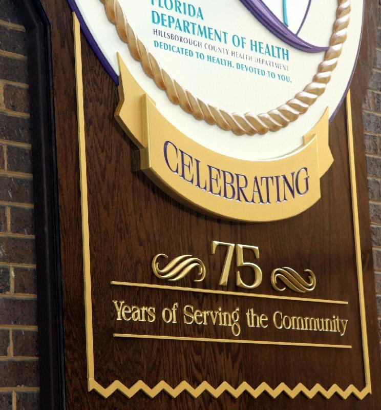

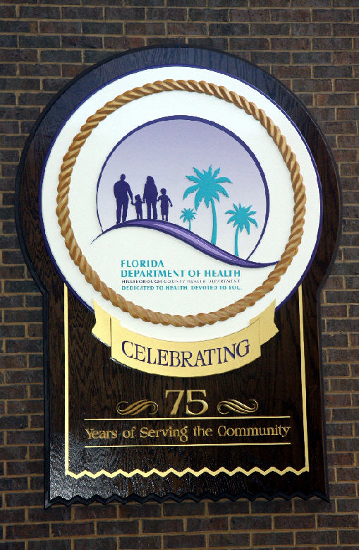

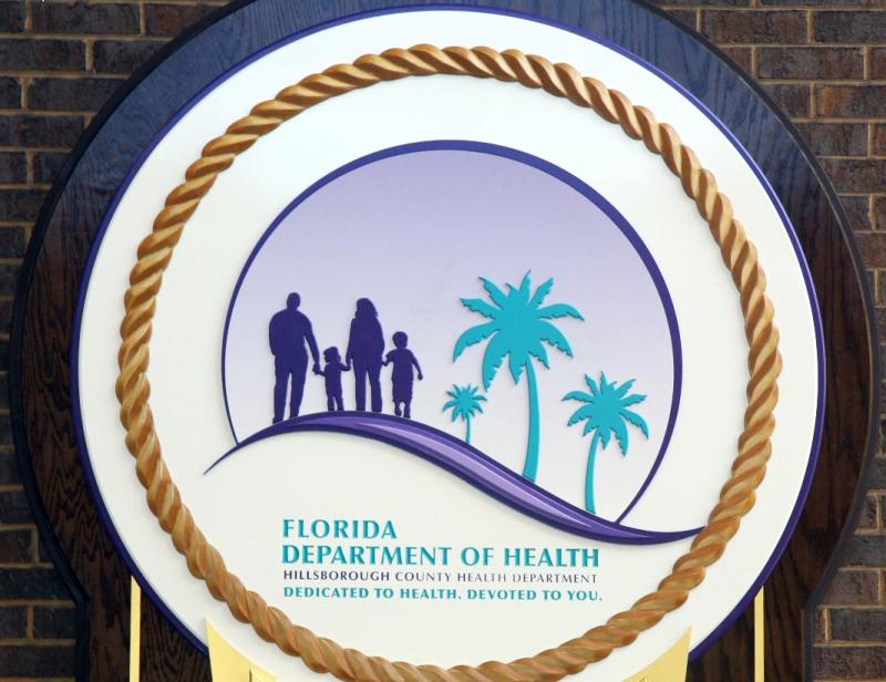

Well back from the install. I hate installs btw... They were pleased and I'm glad to be moving on to the next project. Here are a few better shots.
Face is two sheets of 4'x8' 3/4" oak plywood joined and cut down to the 7'h. x 5'w. finish size. The serving copy is v-carved into the wood and the numbers 75, scrolls are prismatic carved. The horizontal lines and inset stripe are 1/4" pvc. The ribbon panel is three layers of PVC stacked and carved. The rope border is all carved and hand painted. The logo is four layers of stacked 1/4" pvc with the small lettering v-carved into the white background. The outside edging under the oak is 1-1/2" HDU with a round over. I think that covers most of the details
