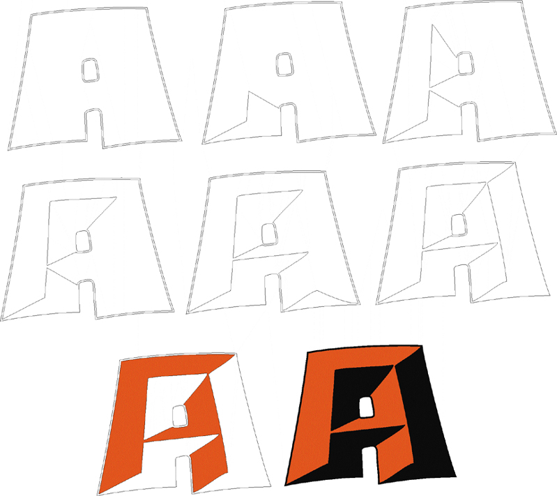

The Letterhead Fonts site tutorial is pretty decent. The method I use is quite a bit more anal retentive, but the results are usually mathematically perfect.
The difference is in how the path down the center of the stroke is established. I break sections of the letter apart into separate line segments and then make a 1 step blend to create the center segment. In Corel you often must use the reverse path direction button to get the center line to fall correctly. Another critical feature is the font must be properly digitized. The blends won't work very well using fonts peppered with lots of extra control points.
Steve C.
My method is different from both. I start with making a small inline contour, reduce nodes and manipulate the points to create the chisel font. Once I get the basic shape I go back and make templetes to measure the center of the strokes. your two color fill is a good idea though, I may try it.
