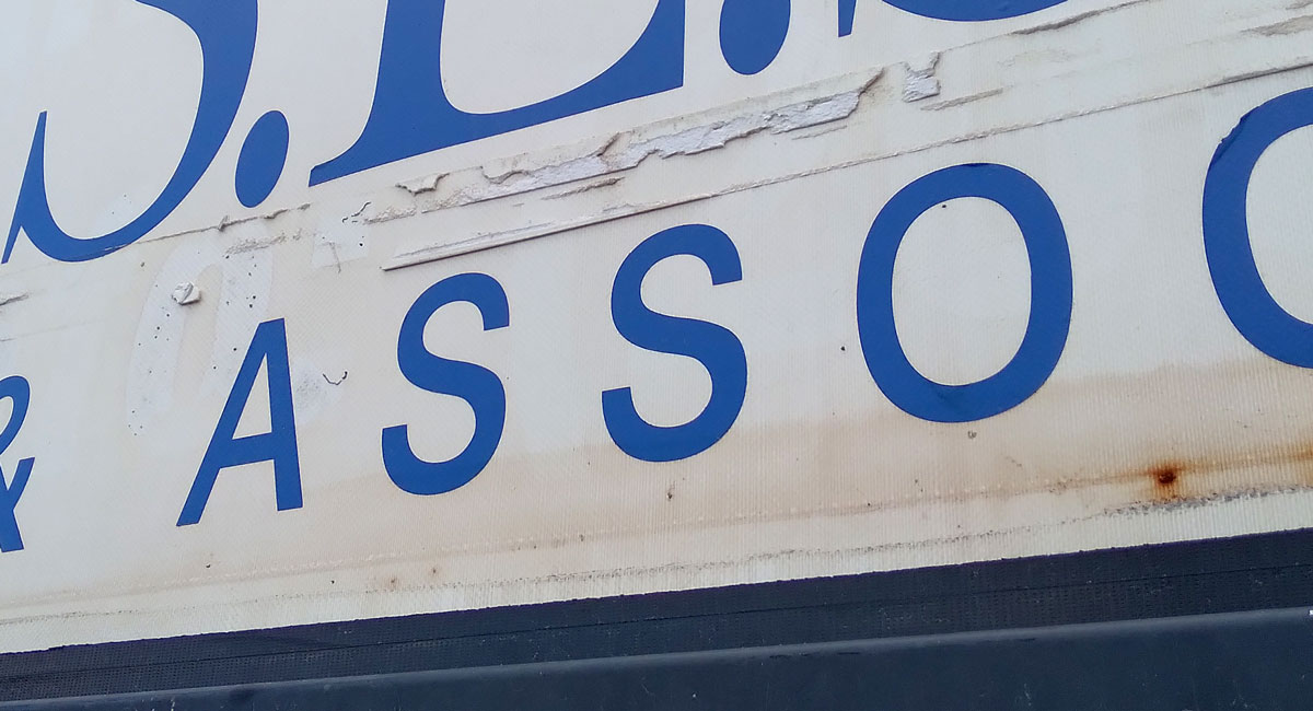

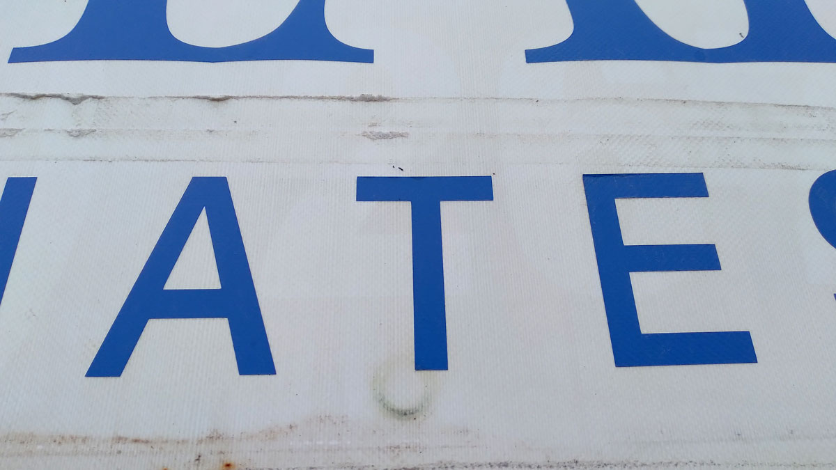

Update on this one. Though I had passed on this project, I had other business in the area yesterday and decided to go check it out. The current image on Google street view doesn't match the actual sign, and this thing is a mess. It's not polycarb at all, I'm guessing flex face? The sign face looked like a heavy woven canvas type of material, or heavy duty banner, and was 'springy' to the touch. One single piece measuring around 82x112". I spoke with the owner who said it was attached with "z-clips" inside, but he didn't know how it was installed, or when. A quick look at the Yesco tag on the side of the cabinet revealed a manufacture date of 1999. The whole thing needs to be replaced and I'm going to refer the customer to Yesco. I don't have any experience with flex face, are there wholesale suppliers? See close up pics.
Yes, call miratec, indy imaging, oxford graphics, and get a quote for the size. Call Yesco and ask them for a price (and time frame) to install a pair of flex faces. Don't throw away your time in figuring out what the material is, artwork, general customer time sink, etc, just because you won't be able to install it yourself!

Also, indicate to Yesco that you plan to reuse flex clips from the original install, you'll need to get them or ask them to bring fresh 1/4" nylon lock nuts.

Why would they sub out for a job that was theirs to begin with? Not being snarky.
The bulbs need to be replaced too, half of them are burned out and I told the owner he should have it upgraded to LED.
They aren't owners of the sign, they just happened to have done it initially. At this point you are subbing it out to them. It's not a bad thing, their sales team can't handle every single little job that pops up, and by doing the leg work, they can send an available crew when their schedule permits it, and have the job complete in one day, two workers only, 0 sales time, 0 art time. This wouldn't be a bad job for them, perhaps slightly less profitable. I'd also wager they would not approach your customer for a direct bid, they are too big and rely on too many small shops around the nation to start poach clients for $1,000 jobs.
I called Yesco and they might be able to work with me. He asked about the clips.

Yeah, if we have to rent a crane to do a flex face, we buy all new clips. Old clips are hard to work with, and on occasion the threads rust away. If nothing else, new nuts are required. You might as well ask Yesco what they'd charge for a proper survey of the clips and dimensions to avoid any surprises, and they could survey the existing lamps for LED sticks while they're there.

I agree with Burton.. don't throw that away. Get your cost on the flexface from indyimaging, get a quote from Yesco... 50% markup and throw it at them. Mention their sign has ass and ate and wink at them. They will pay the extra.
I've done those flexface by myself with one bucket. I get a helper to make it easier.
